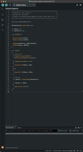

Good Morning All !!
So I'm getting a little closer, I did what @runaway_pancake said and broke the sketch down to bare basics. The communications part of it seems to work fine, however, I can't get the relay to close with a button push from the other side. Let me elaborate.
On the SLAVE device there is a push button. When I press the button I see the "a" populate on the serial monitor of the MASTER device. So it's communicating. When I separate the reed switch on the MASTER device, I see "b" in the serial monitor of the SLAVE device. Everything works except when the MASTER sees the "a" it doesn't close the relay. It's just a 5 volt relay soldered to the PCB.
I tested the relay and it works. If I manually set it to LOW in the sketch it closes just fine. I thought I had it set correctly but apparently I don't. Please take a look at my bare bones sketch as well as the pictures demonstrating communication. Thanks again.

You did not fix the issue mentioned in reply #2.
Actually I fixed it, everything works as it should. I feel kinda dumb for this but the problem was with one of my HC-05 modules. This small PCB is going into a small project box so I had to de-solder the angled pins, the re-solder straight pins. Something must have gotten too hot and the modules only worked one way. I setup two new modules and everything is good. I'm sorry for wasting everyones time but thanks for helping me anyway. :face_with_open_eyes_and_hand_over_mouth: I'm so embarrassed.
