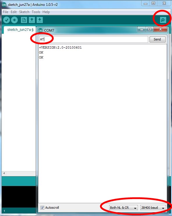

I have 3 or 4 hc05 modules, and to use the AT commands every one of them requires this:
  1. power up the hc-05 while holding in the onboard pushbutton, then release the button. the module should go into programming mode and the led should blink about once every two seconds.
  2. open arduino serial monitor. Line ending should be set to “Both NL & CR”
3.Baud speed should be set to “38400 baud” for the AT programming mode.
You mentioned baud in the OP, but its unclear whether or not you had it set at 38400?

No sketch or arduino needed for simple sending of AT commands, just the hc05 module and the usb to uart converter, connected as I mentioned previously. You will need the serial monitor or another terminal software like putty, etc.
Yes, I'm in USA
I really think your troubles are from not setting baud at 38400 for the hc05:-)

If (you held in the button while you powered the hc05, and it entered programming mode. This is
demonstrated by the led flashing slowly about once every two seconds,)
and If (you had Arduino serial monitor set for 'both NL and CR' and 38400 Baud)
and If (you then typed 'AT', pressed enter, and still did not get the 'OK' response)
and If (your connections are the same as I have shown in the attached pic)
Then (I don't think its settings, but I can suggest no further advice, perhaps the module is different than mine, or is damaged...)
I tested this exact procedure just now, all of my hc05 modules require this exact method for sending AT
commands...
good luck!

Hi Billcat,
still haven't received the new HC05 so set the broken one up as per your instructions, still nothing, swapped the TX and RX round as I had nothing to loose, obviously still nothing, swapped them back to your layout and it started working again. How weird. Thanks again.
