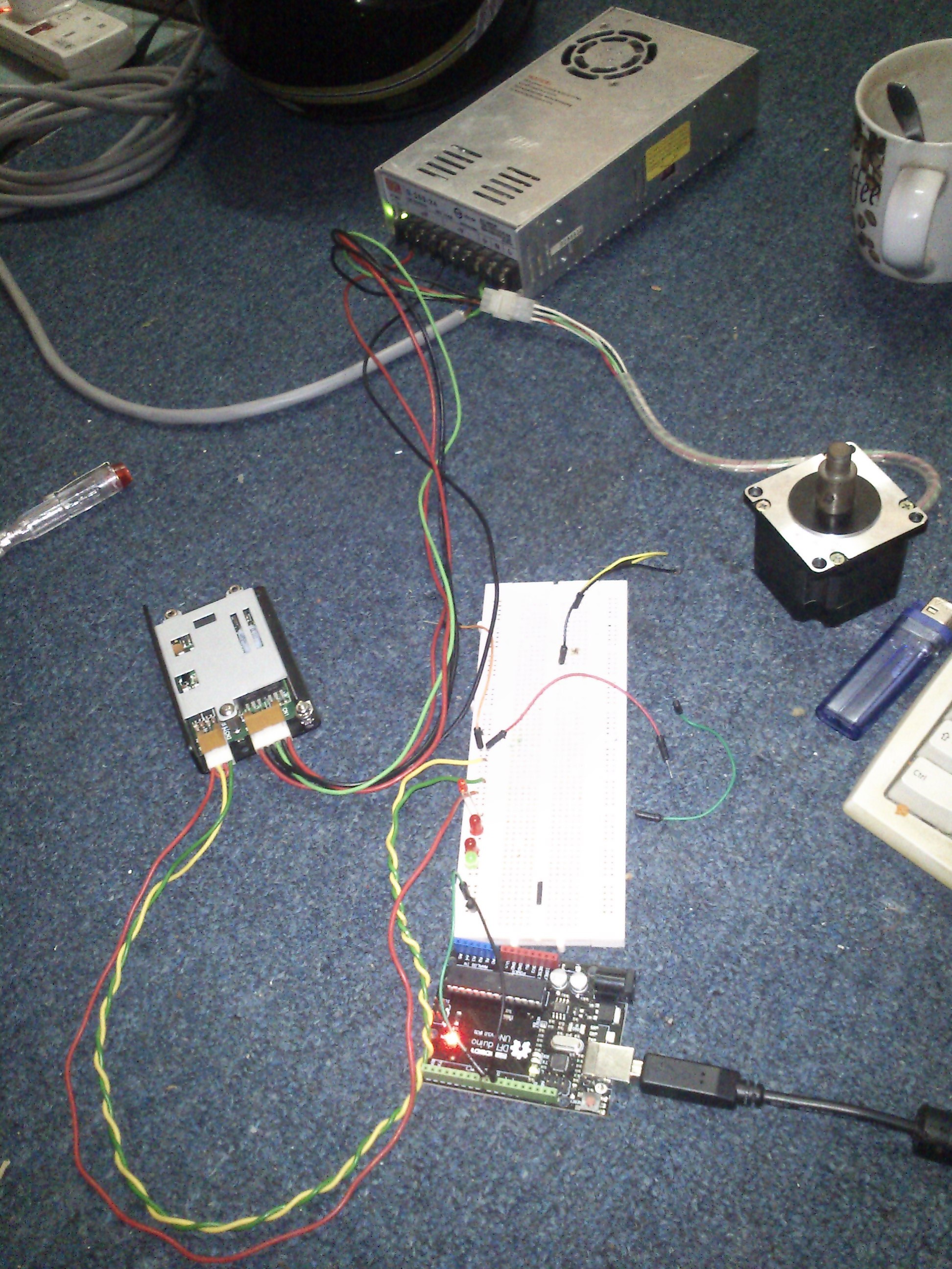

here i attached the datasheet ......well i has try many code in it but the motor still no response.... maybe because of the arduino code or the driver it self....i read at some forums this type of driver need a proper frequency input to make it function that why i want to measure the arduino output

errr sir....can i know where should i put for pulse and dir pin for the + and -
Each '-' input goes to GND, each '+' input to the relevant Arduino pin, which
needs to be an OUTPUT pin.
Then when the Arduino pin is HIGH the opto-coupler will be activated for that pin.
You could also add an LED and 1k resistor to the pin to show you what state it is
if you want to see what's happening.

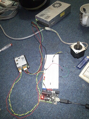

the motor still wont move :(....should i change the currnet jumper setting to 1.2amp cause i dont know my motor spec
I can't work out from your photo where exactly each connection goes. Please make a clear drawing of exactly how everything is connected and post a photo of the drawing.
...R
