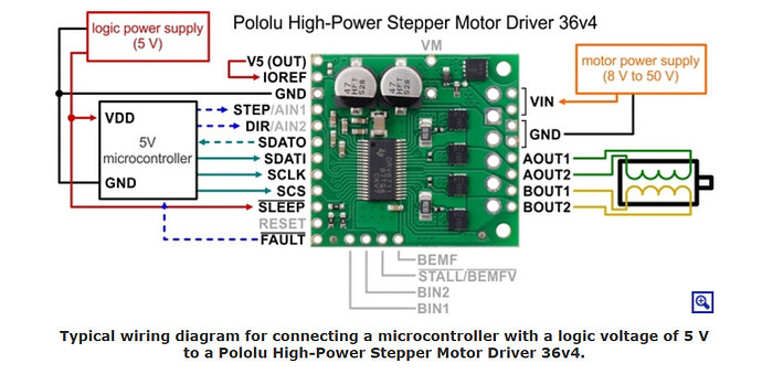

Hello,
I am trying to use an Arduino MEGA to control a NEMA 17 stepper motor (https://amzn.eu/d/8sh1eRl) with a Pololu 36v4 driver (Pololu High-Power Stepper Motor Driver 36v4). I followed the proposed setup as shown in the typical wiring diagram but moved the pins SDATO, SDATI, SCLK to pins 53, 52, and 51 on the arduino MEGA. I tried to use the BasicStepping example that comes with the arduino library (GitHub - pololu/high-power-stepper-driver-arduino: Arduino library for Pololu High-Power Stepper Motor Drivers) but the motor does not seem to be moving. Around the Vin and GND, I measured 12V but then the driver motor windings don't seem to have any current flowing in them.
Anyone have any idea why this might happen? Is it possible that the arduino mega is not compatible with this driver?
Thanks in advance for the help!
Mega is compatible. Did you set the max current on code?
Instead of writing about your wiring, post a scheme of actual wiring and also post the code you are using.
Hi kmin, thanks for the answer. Yes, I have set the max current to 1.4A in the code. This is the scheme of my wiring :
As for the code being used is exactly the example from Basic Stepping apart from small changes to maxcurrent and delays... : ```#include <SPI.h>

Please read this an post your code properly using Code Tags:
Pleas fix your post with code tags.
Then tell us from where those pins 51-53 came to the game?
It’s not clear to me, but the driver logic voltage is derived ‘on board’ from the motor voltage - hence the ‘motor ground’ must be the same as the control ground for the inputs to be relevant.
Confirm with a multimeter the input and motor grounds are commoner together.
