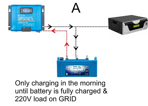

I have a solar MPPT charge controller which is connected in parallel to an independent inverter with battery. The MPPT charge controller can generate around 90amps at the output.
The grid feed to the inverter goes via a relay inside the MPPT charge controller. When the battery is discharged and solar is available in the early morning, the controller puts the 220V load on the grid and charges the battery at a controlled amps, until the battery is fully charged.

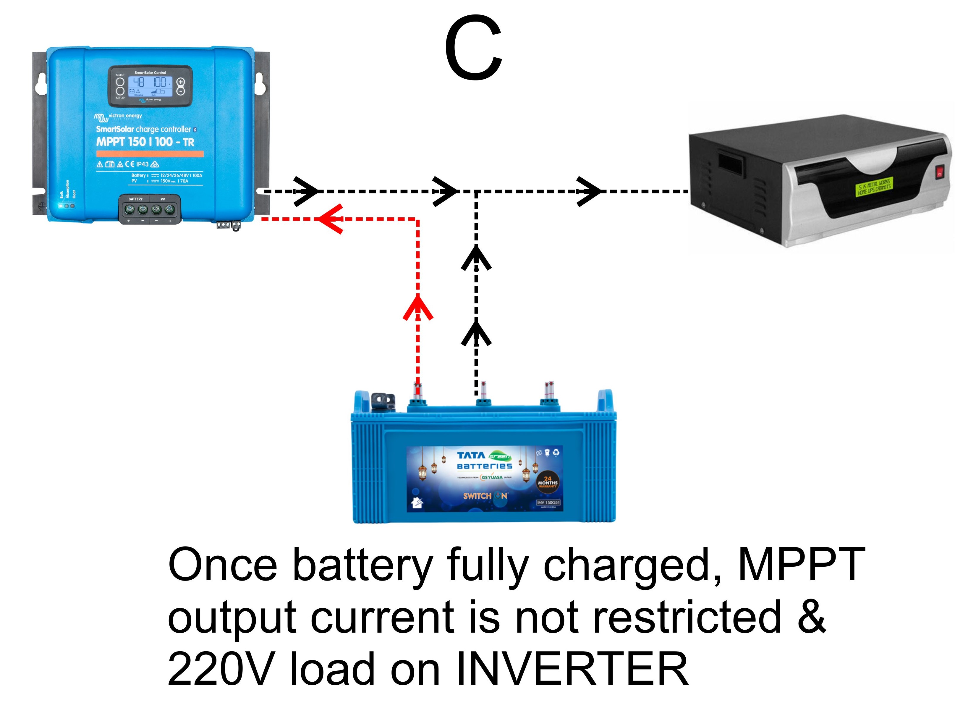

Once the battery is fully charged, it will no more draw high amps, hence the MPPT then shifts the 220V load from the grid to the inverter which is then powered only by the MPPT's DC output at high amps.
Now, the amount of time the battery is taking to recharge, the solar generated power is not being used by the inverter, as the amp is restricted to 20amps (can be set on the controller) only.

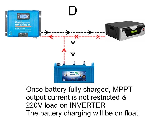

I want to set the MPPT controller to output full amps all the time and run the inverter from the controller and also use 20 to 30 amps to recharge the battery.

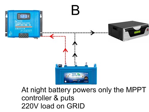

Challenge is, the MPPT controller needs supply from the battery to run itself.

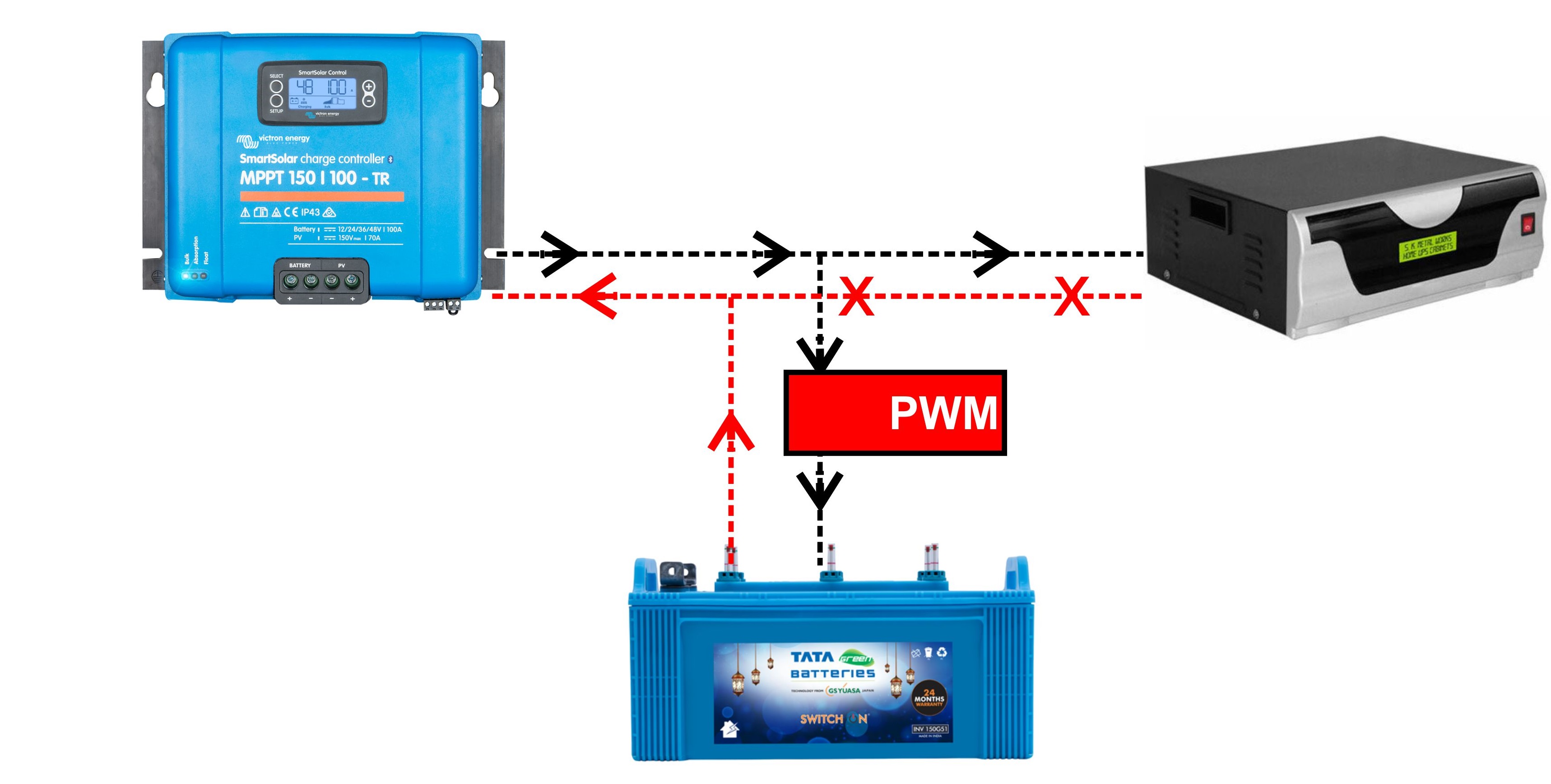

Below is the block diagram of how everything is connected.
RED dotted lines show current flowing to the MPPT controller to power it.
I would like select condition D at the day time and control the amps to charge the battery. The excess current produced by the MPPT controller can be used by the inverter. If the MPPT is unable to produce enough current (due to clouds) needed by the inverter, then the current limiter charging circuit will go off and let the extra needed current to flow to the inverter from the battery.
Challenge is how do I power the MPPT controller while I charge the battery with controlled amps. Also restrict have to restrict current flowing from the battery to the inverter.
The MPPT controller does not power ON until it gets power from the battery.

But the challenge I am telling you is, then how do I power the charge controller with the same battery..?
Look at the picture below..
BLACK dotted lines shows current flowing to the inverter, and RED line shows that the battery has to power the charge controller but the same power has to be restricted to the inverter.
While I put the PWM charger between the BLACK line to the battery, the MPPT controller has to be powered too by the same battery. How do I solve this..?
