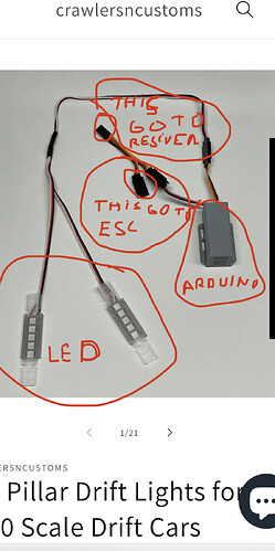

HELP Im trying to creat an arruino that read the throttle signal and brake and send it to led strip like formula drift decel light for rc car
HELP HELP sim trying to make arduino nano to read signal from esc and send it to led strip so I can see on what throttle position I am for more reference Is a decel light for drift car someone already did it but is to expensive so I need make my
Can you access the PWM (servo) signal before the ESC?
There are lots of tutorials on the internet on how to read the servo PWM signals from a RC receiver.
Hi I’m new on this my friend I have a rc drift car and I whant to add a arduino between esc from rc to reciver and send the signal to led strip
To know if the car is in neutral positions to be one led on green and if I press reverse the led light on red and if I press throttle the led turn on blue I know can be possible someone did it but is to expensive thanks for the help
And depend on the throttle position the led go up led by led
What Аrduino are you using? Have you tried anything? If you expect someone to do everything for you, try paid consulting. I don't mean to discourage you but just because someone has done something doesn't mean anyone can do that thing. This project doesn't seem very complicated to me, but it depends a lot on what electronics and programming knowledge you have.
Im new on this my friend I just know is a arduino nano
I prefer wait for some that want to help me

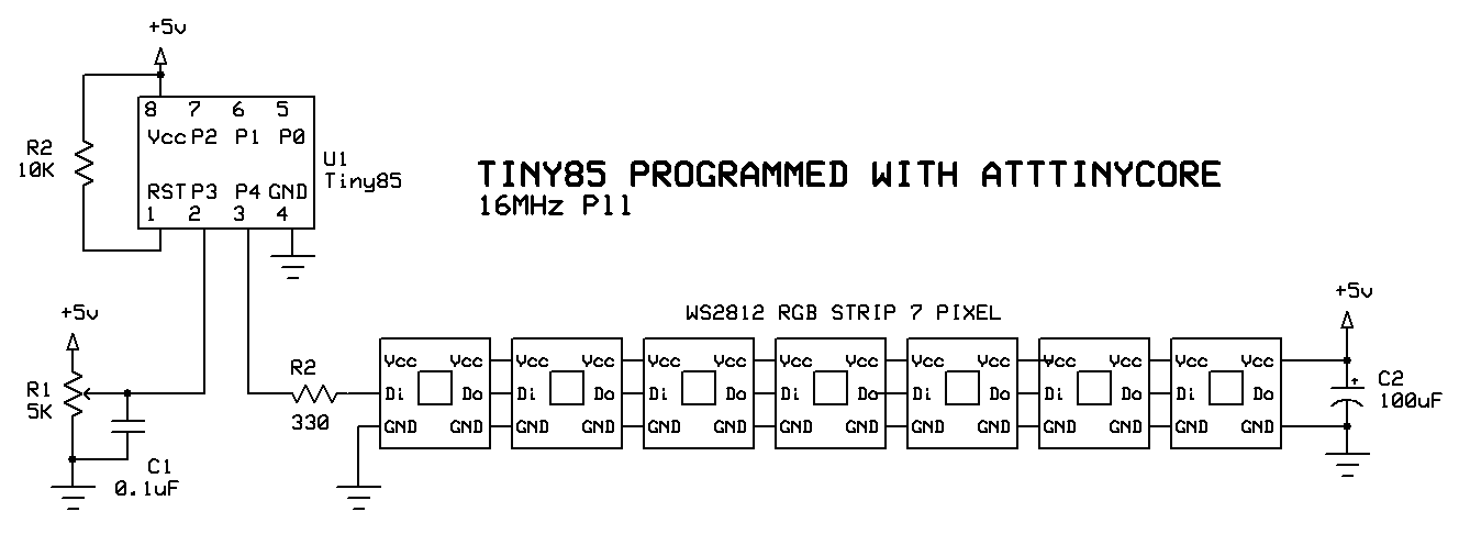

Here is code and schematic for tiny85. Successfully tested on real hardware.
// by groundFungus aka c.goulding

Ok my friend u helps me a lot so what you recommend me to buy apart from the led
What is the output voltage of the receiver. An Nano input can (will) be damaged by any voltage over Vcc + 0.5V so you may need a voltage divider on the receiver output to drop the voltage to a safe level.
Aside from what is on the schematic, I don't know what else.
