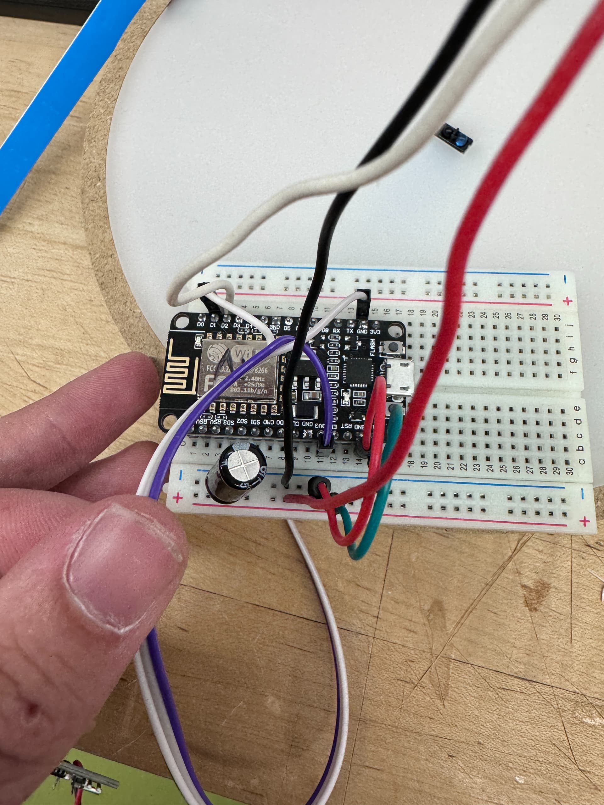

Hello, I need some help/advice on how to improve my interactive game setup. I am trying to create an interactive agility light pod system where when one lights up you run to that pod and it will register with a hand and then randomly choose another pod to light up.
Any help is greatly appreciated!
Here is a list of everything I am using.
- NodeMCU ESP8266 CP2102 ESP-12E Module:
- NeoPixel LED Strip: 30 Leds
- TCRT5000 IR Sensor
- Power Supply using a 18650 battery with a capacity of 3300mAh and a TP4056 charger module with an integrated step-up converter.
- Resistors and Capacitors: For protection I pur a 1000µF capacitor across the power supply lines.
The setup:
Here is the code.
