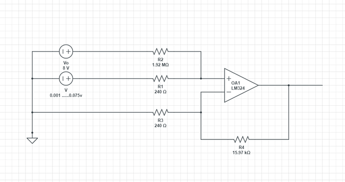

I just learned about amplifiers. I designed a summing amplifier that outputs 0v when input is 0.001v and outputs 5v when input is 0.075v.
I have included the picture of the amplifier.
Please help me to verify it and suggest improvements that can be made.
Thanks

Supply voltage? Why do you need a summing amplifier? Summing amps usually sum at the negative input of the opamp as a virtual earth.
I did say usually. Design of the non inverting type is more involved.
You need to start by learning and being able to apply ohms law.
so what is the current in R2 when V = 0.001V
then kirchoffs laws.
so what is the potential at the junction of R1 & R2 when V = 0.001V
Then the basics of op amps
and
Remember, for any finite voltage at the output the difference voltage at the input must be zero.
and also that a "real" op amp is not able to produce much current at the output;
and that you cant buy a 15.97 k resisitor off the shelf
When I see mV (or uV) I get worried... With low voltages, noise/instability often becomes a problem.
Any existing noise gets amplified by the amplifier and the amplifier itself adds SOME noise so high-gain amplifiers tend to be "worse".
And to get all the way down to zero volts (or very-near zero volts) you should have bipolar power supplies. Bipolar power supplies are pretty standard with op-amps but with digital we don't usually have a handy negative supply so it has to be added.
of course I agree - but since (I'm guessing) the op wants to feed this to a high impedance analog input, there will be "no" current demand on the op amp so a single supply will work (provided he picks suitable resistor values)
Its a trade-off to keep it simple as we usually dont have a negative supply.
Maybe OP can offset his input and output to 2.5V...
An opamp will never reach 0V (without bipolar power source) and linearity is also not guaranteed...

why not? if there is no (or negligible ) current into the output?
MCP6022: 4.2 Rail-to-Rail Output
The maximum output voltage swing is the maximum
swing possible under a particular output load. According
to the specification table, the output can reach within
20 mV of either supply rail when RL = 10 k
if you've seen this thread, I think thats a fair assumption
Op requires a 0V output when....
20mV is not 0V...
OK, I must admit the specs of this opamp are pretty impressive and indeed very close to rail to rail...
