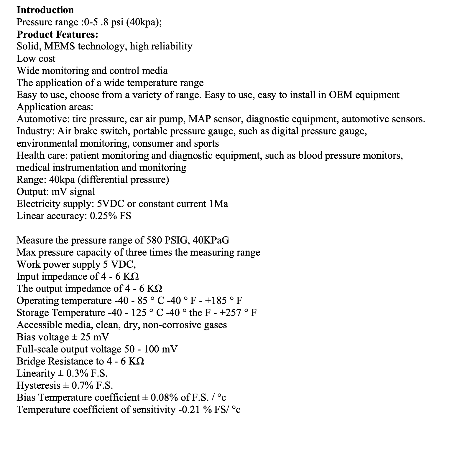

I seacrhed in vain for a datasheet, all I could find was this:
Measure the branch resistances R1, R2, R3, R4 and post values.
Then if you join 1 - 6 you have a wheatstone bridge circuit.
Your LM358 will run nicely from 5V. You can use this circuit
but you may need to reduce the resistor values eg R2 = 1M, R1 = 33k.
You will not get 0-5V output because its not a rail-rail op amp; you would need to use split supplies of at least +8V, -3V.
I'm pretty sure the device is a "Pressure Sensor MPS20N0040D-S."
The relevant part of the data sheet is :
See post #90.

The info you requested for: R1= 4.82k R2= 4.85k R3= 4.83k R4=4.85
My sensor is a lot like the "MPS20N0040D-S" mentioned by EmilyJane which is quite like the one you posted. The only differnce being the pin configuration. In comparison, the +output is taken from pin 4.
