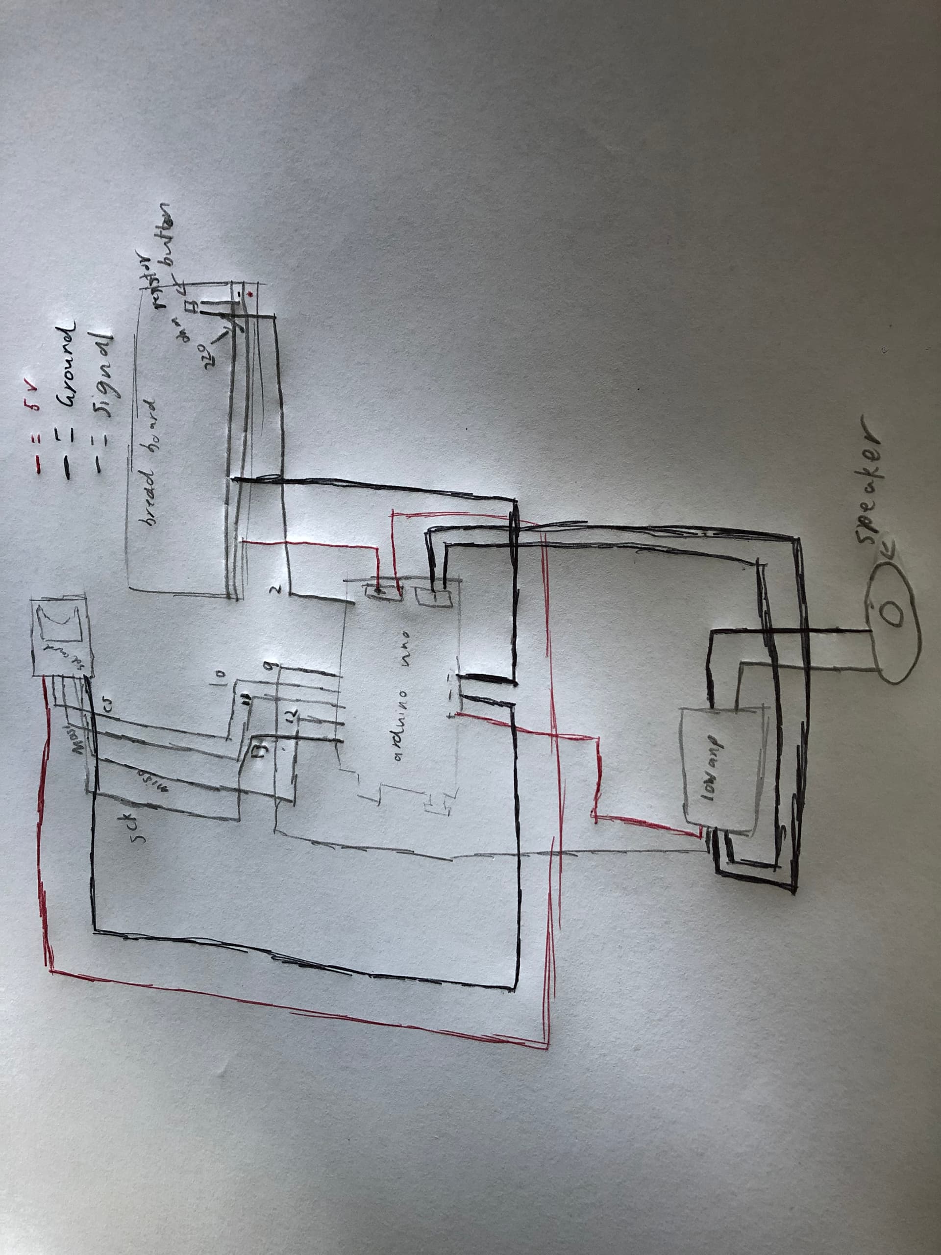

Hi i am trying to make a sound efect when i push a button but the sound comes out really bad. Does anyone know how to have clear sound?
I am using a 12w speaker and a 10w amp.
This is my code
So make one. It's going to be essential, I'm afraid.
Alternatively, some GOOD photos of your setup might also do the trick (but a schematic is better).

BTw, I'll bet you a dollar that you have both coding problems (see some above; there's more) and likely a hardware issue as well. Given your description of the bad sound, you're doing something wrong in hooking up the amplifier. But without a schematic or additional info, that's impossible to troubleshoot.

Your photos illustrate the need for a schematic. And perhaps for some simplification. How about having just the arduino, sd card reader and power amplifier hooked up to a suitable power source and giving it a try that way.

Good job on the schematic; can you confirm that the signal to the audio amplifier comes from Arduino pin 9? Because in that case, it's evident that audio quality will be horrible. An Arduino can only output digital signals. Your audio amplifier needs an analog audio signal. You'd need some sort of DAC to do what you want. Usually people go for an SD card module with integrated audio circuitry for this; I assumed that that's what you had.

A speaker needs an analog signal. An Arduino (at least the one you're using) cannot produce one. This explains your 'static'.
A chip (usually) that converts a digital value to an analog signal. Your DFPlayer has one integrated into it.
