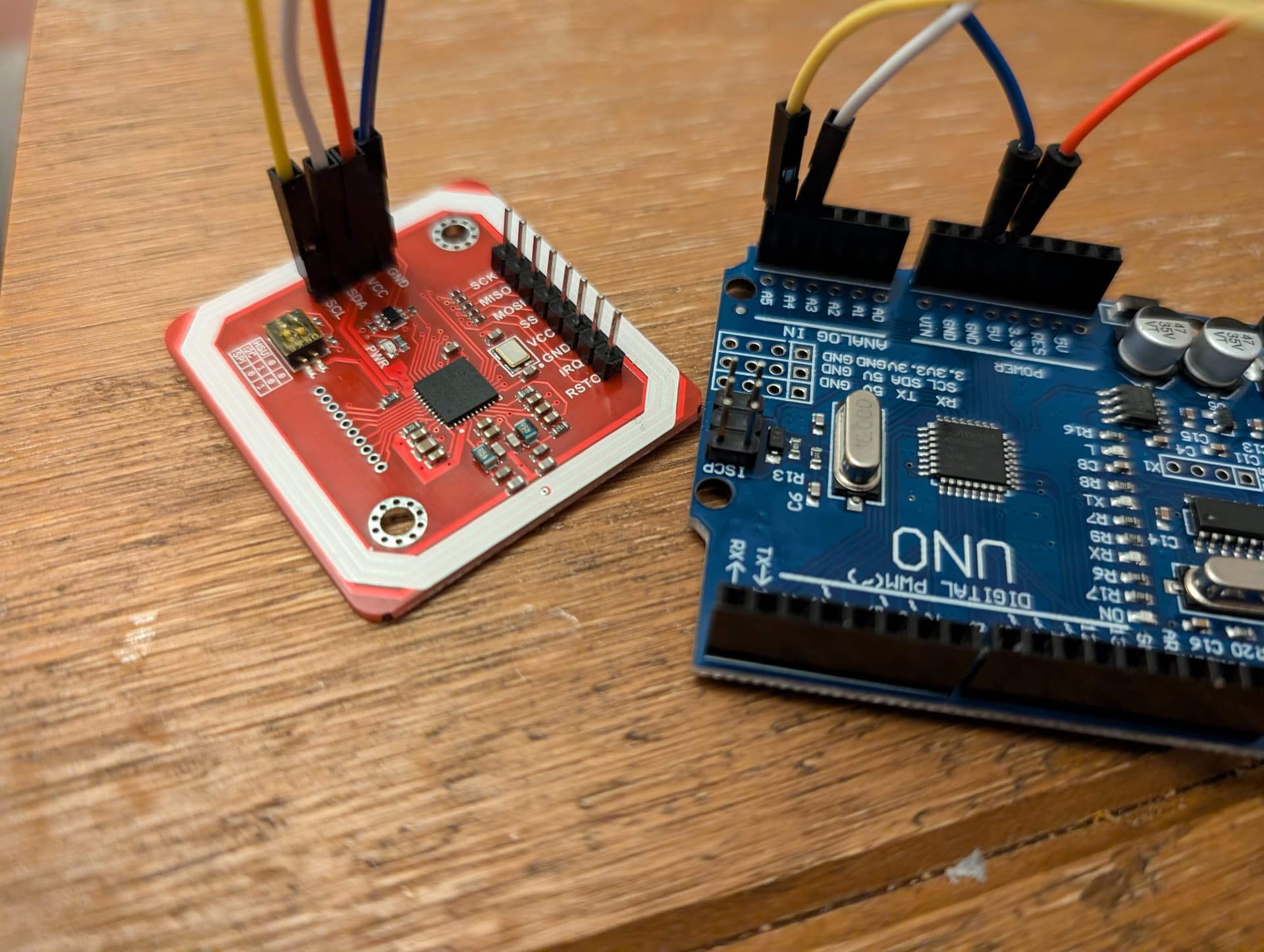

Trying to use a NFC PN532 but the R3 wont detect it?
Im trying to just get a NFC module (PN532) to be detected by the uno r3
My wiring is ...
PN532 VCC to Arduino 5V
PN532 GND to Arduino GND
PN532 SDA to Arduino A4
PN532 SCL to Aduino A5
Actions I have taken -
-Rechecked the wiring and tried different wires.
  • Tried different libraries for the NFC module
  • I havent tried a different module because I dont have one - the one i have does power up.
  • prayed to the god of electronics

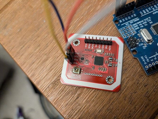

I have set the jumper to I2C mode, i think.
the code to find if I2C is connected is below...

Do you have any other IIC device you could try - just to verify the diagnostic is working.
Does this module have pullup resistors fitted to these two lines? They should be pulled up to Vcc. Try adding two resistors of 3k3 or 4k7 between both of these pins and 5V.

I dont believe it has pullup resistors so im trying to install them . Im not sure I really understand (im new to all this).
this is how ive installed them....
im sure this is probably wrong if someone could comment.

That is correct but I would use 4.7K
I used 10k because thats all I had. Ill order some 4.7k and hope it works.
definately didnt work using the design above
Which way is '1'?
Try it one way then the other. (Reset between tries.)
You can put two 10K in parallel to give 5K
No it's not, you're doing great. Heed @jim-p 's suggestions above. Use 2x 10k in parallel for each SDA and SCL. This makes 5k on each, which should be ample.

Also do what @dougp suggested and try the I2C scanner sketch with a different I2C device. Maybe you have an LCD display with I2C backpack lying around, or some kind of other sensor? Give that a try.

I tried to wire in parallel. No luck either im afraid.
Also tried @anon85221860 idea of changing the jumpers.
I think its likely that this module is faulty but Ive ordered some more I2C devices to test them also.
