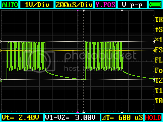

The problem I'm having seems to be related to the current drawn by the LED circuit. If I wire up the circuit as in the diagram then the ATtiny85V is not happy at all. As soon as my program initiates PWM on pin 6 then the MCU resets itself. If I substitute the 1.5 ohm resistor with a 10 ohm resistor then the circuit will work (trace below), but the current through the LED is obviously nowhere near the level I'm hoping for.

I think you're on to something here. I tried a gate resistor of 100R and it didn't work so I upped it to 150R. That worked. Here's the modified schematic also showing the regulator. The capacitors are not new, they were always there and are sized according to the datasheet. I've also dropped the LED resistor to 1R since Vds on the mosfet seems to be more like 0.2V than the 0.1V I had designed for.
This gives the following 600us pulse shape measured across the LED:
Consulting the LED datasheet I can see that the measured voltage drop of 2.1V equates to a current of about 600mA:
So it looks like I'm now getting the output I was aiming for!
