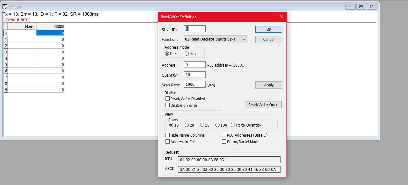

I open modbus poll to see if the data has been transmitted correctly i get an error when i push the button, the LCD prints S1: High but modbus poll shows
"insufficient bytes received"
The Arduino IDE serial monitor also show's 3-4 square boxes and a weird character, not the information expected to be transmitted. I am quite frankly not sure what is going wrong here as the code is identical to the example and people have been able to get that working fine, it just seems like my byte data being trasmitted isn't correct. Any help would be gratefully appreciated and Thankyou in advance!

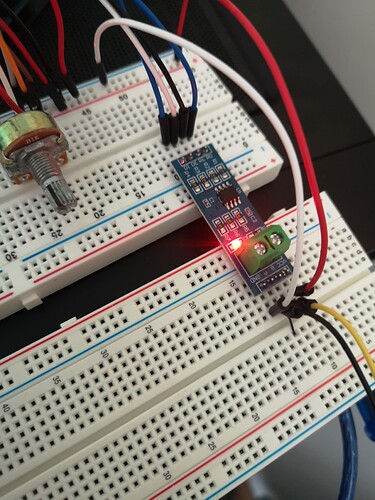

Can anyone help? Can provide pictures of my wiring setup. Keep getting checksum error or insufficient bytes received

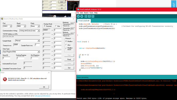

Hi mark, i downloaded modbus tester and at the top next to read to says "error in RS port". I have included a picture above labelled modbus tester, any ideas?
Hmm, I don't have any modbus capable equipment here so i'm not sure. I downloaded the tester and it doesn't look like the one shown in your "modbus tester.png" file. Maybe when you have a real bus connected up, and hit read, then you end up with the screen you see.
Mine looks like the one in the attached screenshot.

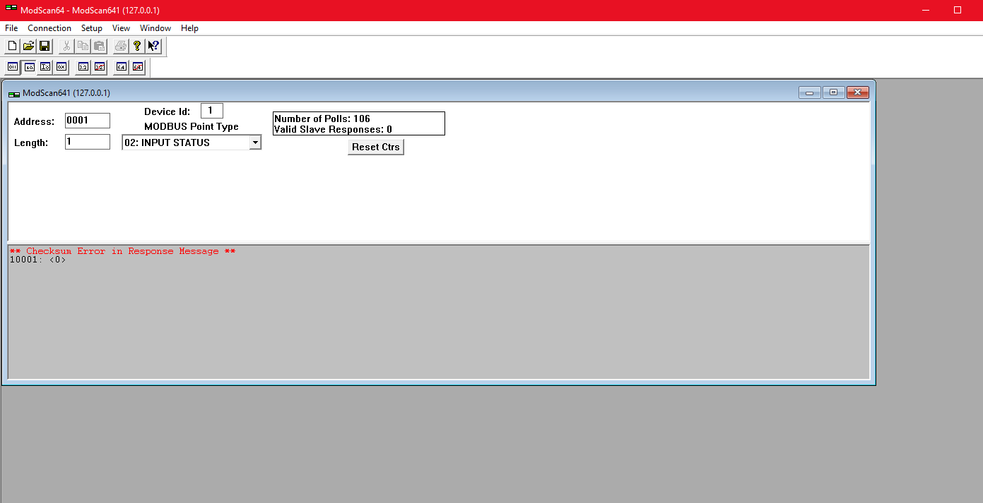

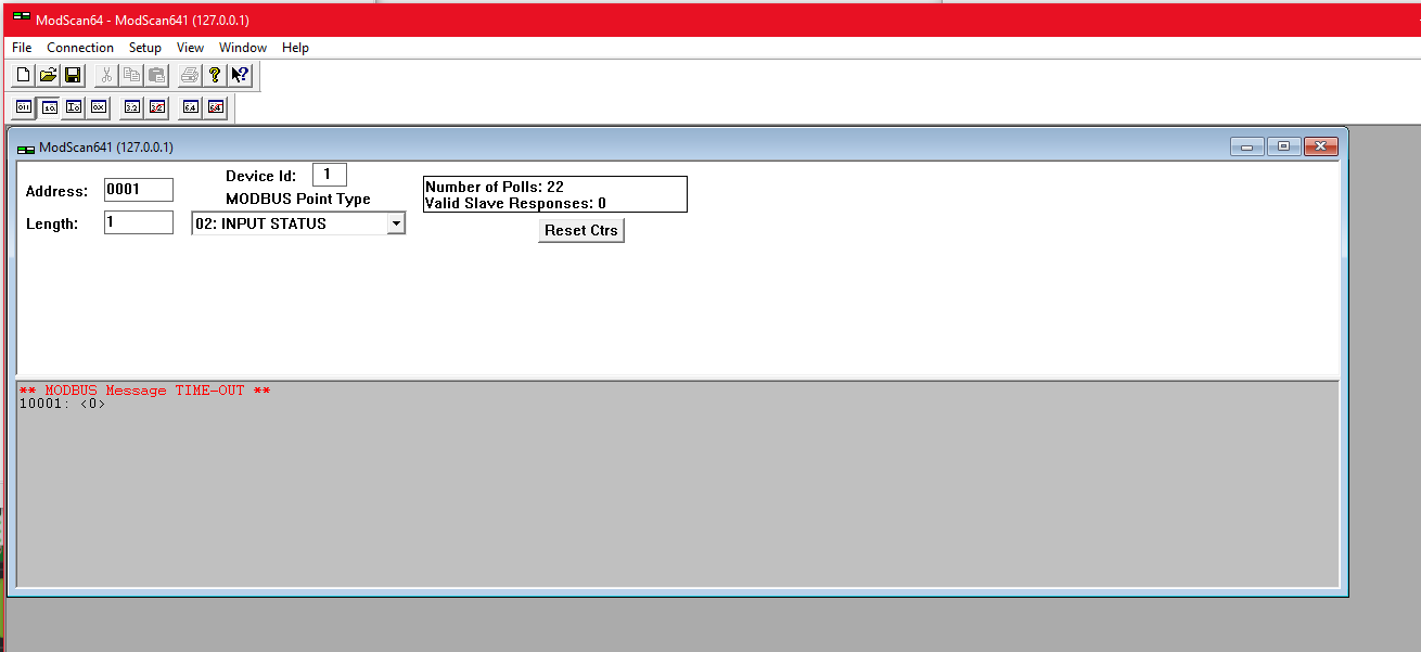

Hello Mark, i couldn't find the download link for that tester. After doing some research i came across the modscan64 software. I have reconnected my project and i am still receiving the same errors. When i try to write
"node.writeSingleRegister(0x10001,1 );" i receive on the tester software the following -
Whilst system is idle i get " Modbus Message "TIME-OUT" " and when i press my discrete input to send the above data i receive "checksum error in response message" I have posted a picture to these errors above under modscan64 "timeout" & modscan64 "checksum error"
I have connected the software to COM3 through the rs485 to usb converter.

Okay thanks for the explanation, i found the program and downloaded. Typed the settings in and attempted to read the modbus through COM3. I then got a CRC error which can be seen in the CRC error.png i just posted, maybe this will shed a little light on the situation? Am i just not sending the data correctly?
I have also just added a screen caption of the wiring diagram, i'm sure my wiring is correct. I've rewired the project 5 times now and still receiving same errors. I have seen on other posts to do with rs 485 chip that people sometimes ground some of the pins like DI,DE etc. Could this maybe help here?

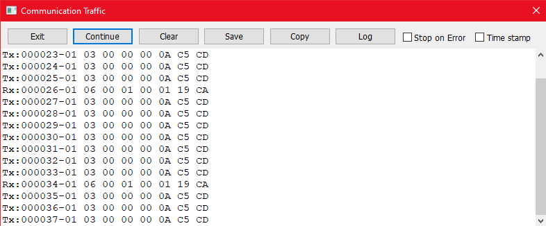

I have just posted a screenshot of the communication traffic between RX & TX. Does this data look correct to you?
I'm trying to get my head around Modbus as i've not used it.
What I can tell you is that the error message you are getting:
arduino303:
"warning: large integer implicitly truncated to unsigned type [-Woverflow]
node.writeSingleRegister(0x40001, 1);"
is because the writeSingleRegister() function is expecting a 16 bit address and the 0x40001 is bigger than 16 bits. Perhaps you meant to write 0x4001?
Looking at the screenshot of the traffic, i'm trying to decode it just to see if everything is there.
In the message "01 06 00 01 00 01 19 CA", it looks like:
"01"    = Slave Address - looks good as that's the address you've set
"06"    = WriteSingleRegister - looks good as that's the command you want
"00 01" = Address you are writing to - the lower 16 bits of the 0x40001
"00 01" = Data to write
"19 CA" = Checksum
From my limited knowledge, you are communicating in binary, rather than ASCII, so your message should be 8 bytes, which it is. This may also explain why the Arduino IDE serial monitor "show's 3-4 square boxes and a weird character".

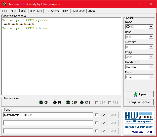

For a number of years i've used a free program called Hercules from HW-Group that can view binary serial data. You can find it here. That might show you the data that you are sending.

Okay so i changed the address to "node.writeSingleRegister(40001, 1);" and the compile error disappeared great! One step closer, i downloaded Hercules and pressed the input 3 times on COM3 to see the serial data which is strange characters i think this is to be expected as have read in places it's hard to intercept the actual serial data. I have posted a screenshot of this in the original post, i tested Modbuspoll again and i'm unfortunately still receiving the errors "timeout error" and when the input is pressed, "insufficient bytes received".
The communication traffic has changed, it now looks like it is writing to the address 9C 41 which as you stated above translates to 40001 as opposed to 00 01 address in the previous communication snapshot.
I'm still a little puzzled as to why as soon as i open modbuspoll and connect COM3 i instantly get "timeout error"
If I recall correctly, in Hercules, you can right click on the received data window and change the display format so that it shows bytes rather than ascii characters.
I had a quick look at modbuspoll and I don't think it's what you want to be using. The docs imply that it is a modbus master simulator designed to help develop slave devices. If that's the case, then it sort of makes sense that it would want to do the talking and expect a response from a slave device - maybe the reason for your timeout message.
Your scenario seems to be the opposite in that your arduino is the master and you want the pc to be the slave. If that's the case, then there's a free modbus slave simulator that might be of use. You can find it here.
One of the command line options is a master activity timeout which implies that maybe the modbus master is supposed to be constantly active to avoid these timeouts.
