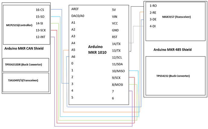

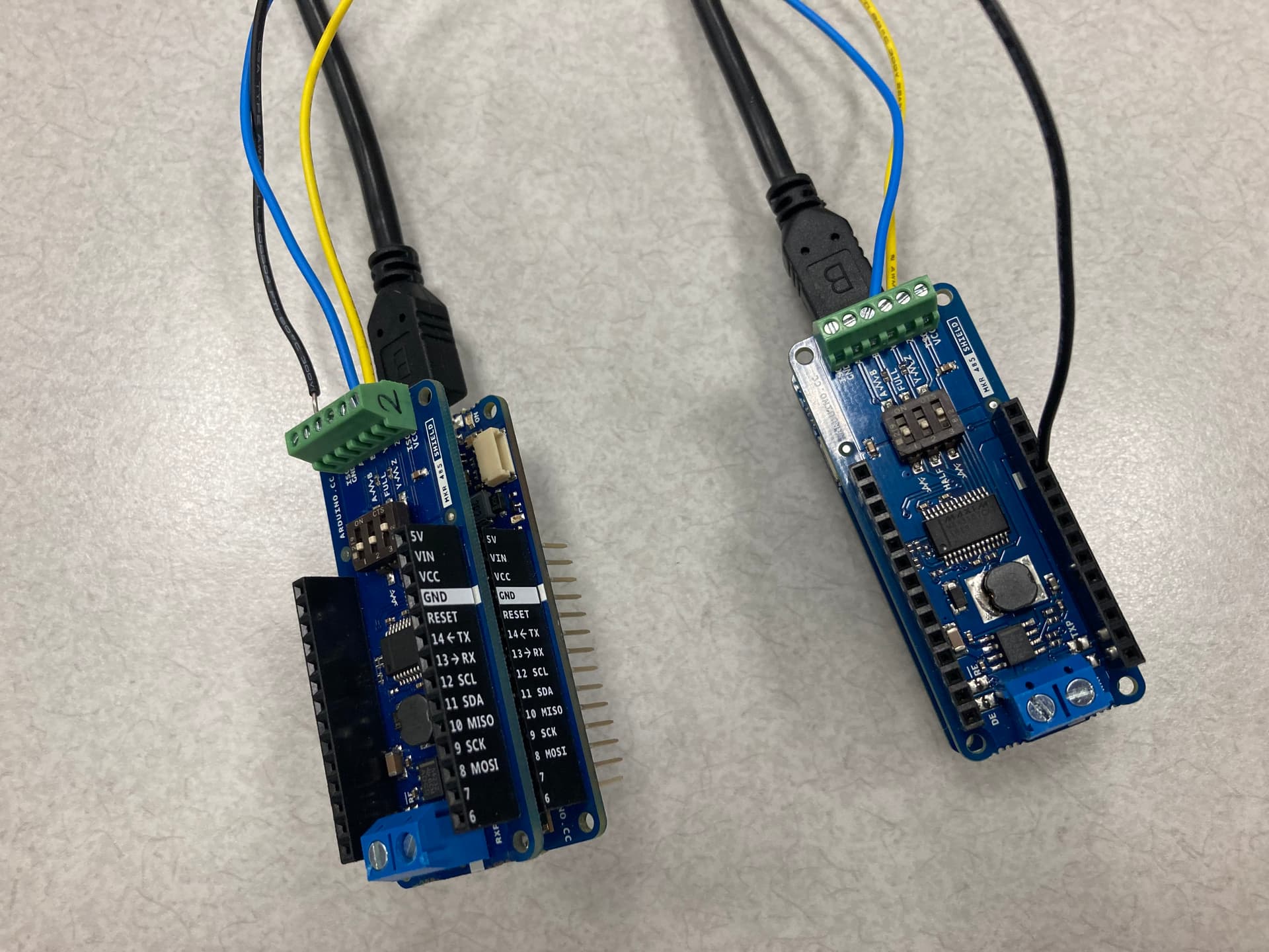

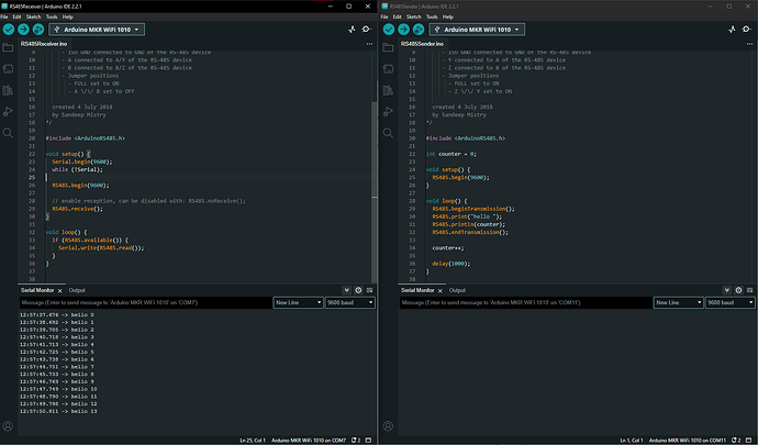

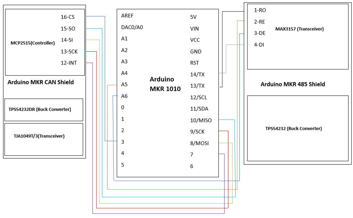

Anyways: Working on a project with an Arduino MKR1010 and MKR CAN and MKR 485 shields to be the controller and communicate with some sensors and such. So far, the Modbus on the MKR 485 shield is providing to be more of a challenge--it's essentially a black box that doesn't work for me.

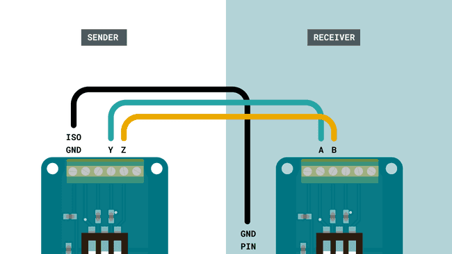

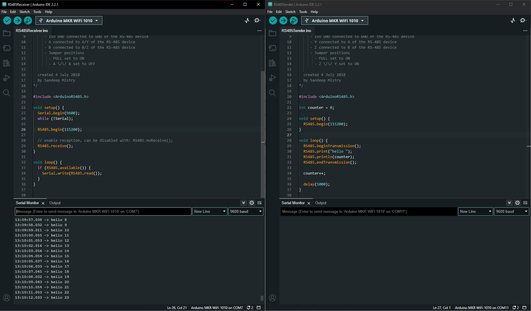

I followed the entire guide on the Getting Started for the Arduino MKR 485 shields. The guide works great for 485 (although, I had to lower the baud rate to 4800 like in this post), but when I then try to load the ArduinoModbus example files (Specifically: Examples → AdruinoModbus → RTU → ModbusRTUClientToggle & ModbusRTUServerLED) included below for convenience:

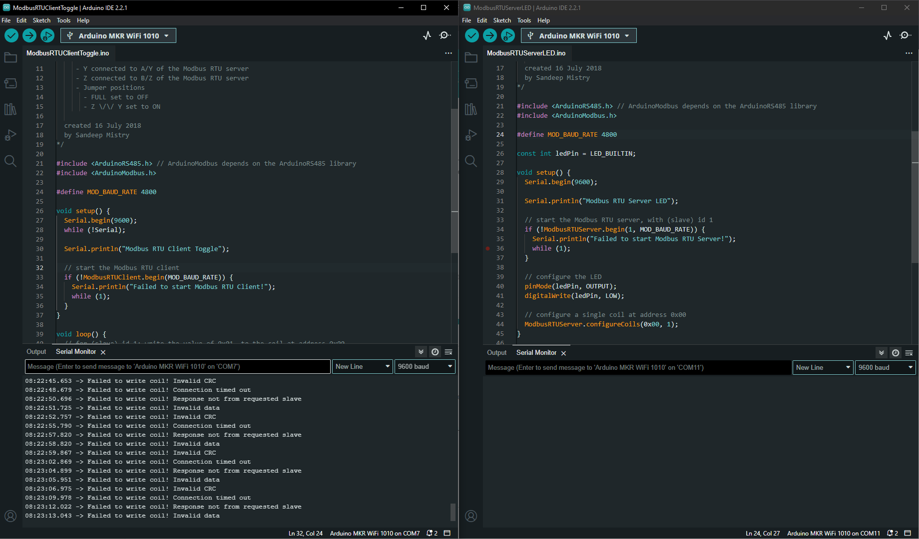

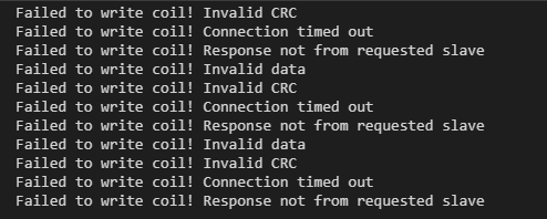

However, I get the following errors:
Failed to write coil! Response not from requested slave
Failed to write coil! Invalid data
Failed to write coil! Invalid CRC
Failed to write coil! Connection timed out
From my research, I haven't really found anything helpful and honestly just similar posts (like this one without an answer from a year ago).

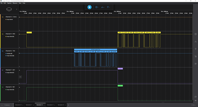

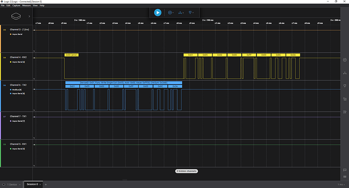

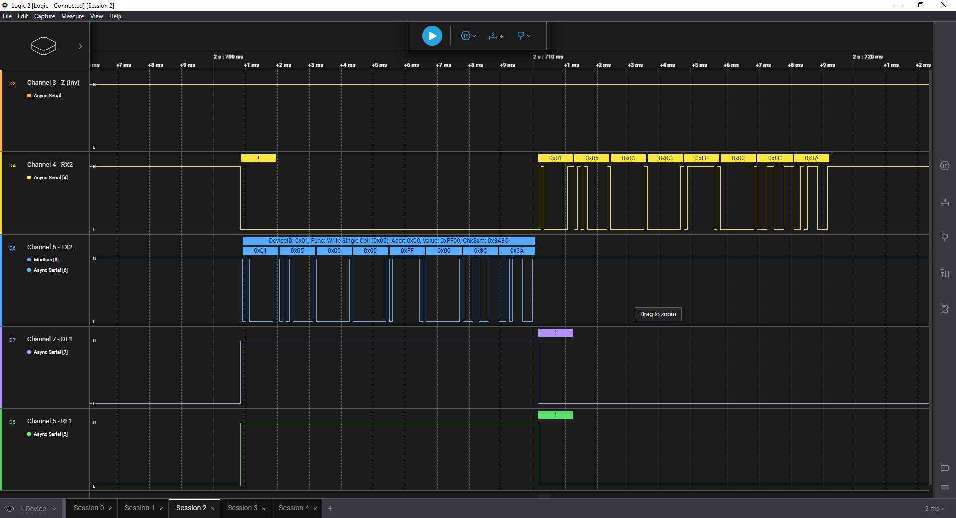

I'm not really sure where to go from here. I tried switching to half-duplex instead of full-duplex, but that didn't really help the Modbus. I have been poking a lot into the ArduinoModbus library GitHub and the issues and PRs etc. They just give me something else to look into without much luck on actual answers.

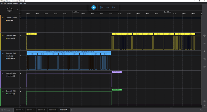

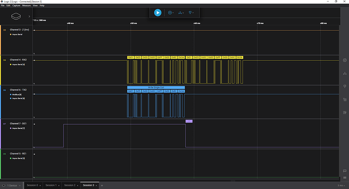

Any answers or tips on where to look or how to debug would be much appreciated! (I have soldered on header pins and been trying to us a J-Link to debug as well as a cheaper logic analyzer (with Saleae Logic software) and an oscilloscope to dig deeper, but maybe I'm in too much over my head?)
