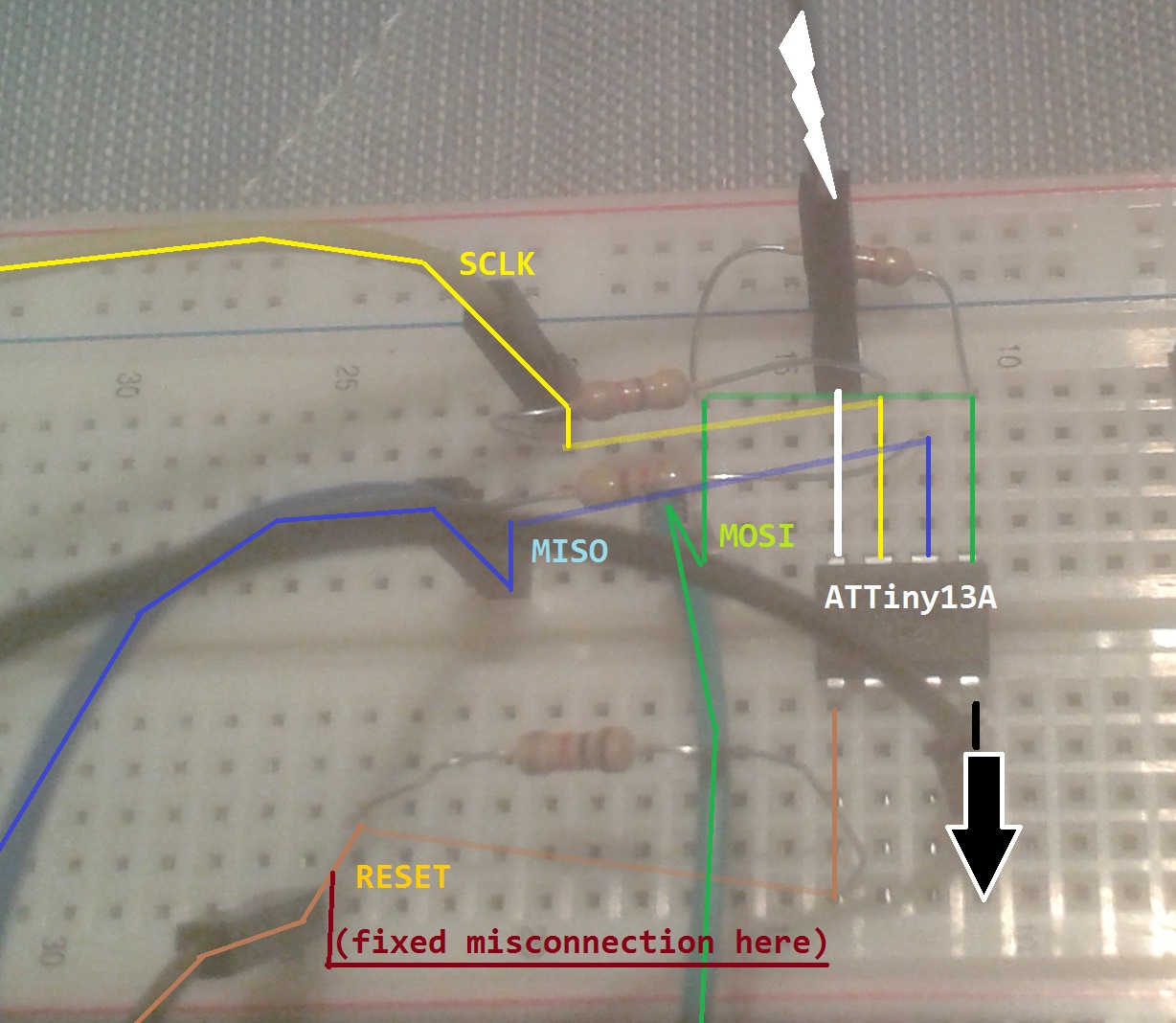

I'm trying to use my ArduinoDue as programmer for external micronontrollers (attiny2313, to be exact). Technically this chip should be able to work on 3.3V, so I'm using no level translators or voltage converters, which simplifies the task (and I don't know how to do it yet anyway ._.).
I've googled it up and did what I could, but it just doesn't work. And now I'm desperate for help.
The first thing I did is loading the ArduinoISP on the Due, only to see it refusing to compile with errors. So I used modified sketch from this topic, and this time uploading succeeded. I've also connected the output leds, so now I can see it is heartbeating. However, whenever I try to connect to ATTiny2313 with avrdude, I receive following errors:
"avrdude -c avrisp -p t2313 -PCOM3 -b19200" -> "stk500_getsync(): not in sync: resp=0x00"
"avrdude -c arduino -p t2313 -PCOM3 -b19200" -> big delay, blinking leds, then "stk500_getsync(): not in sync: resp=0x00".
When I try to use "arduino" as avrdude programmer (example 2), it seems to be resetting, judging by the blinking pattern. I've also tried both native and programming port, with same results... uh-oh.
Update: when I was writing previous sentence and, in parallel, trying to make this thing work, I suddenly leaped forward. Now, finally, avrdude does succesfully recognizes Due (connected to native port). It doesn't reset, happily sees it as a programmer, but... now it says that my chip has an invalid signature:
Device signature = 0xffffff
Yikes!  Invalid device signature.
Double check connections and try again, or use -F to override
this check.
I thought it was the wiring, but no. All the wires are connected right where they should, if the comment in the ArduinoISP.ino is correct.
What am I supposed to do? Should I use another sketch? Disable the reset somehow? Use some advanced technique of wiring?..
Thank you in advance. :3

Right now my wiring is like this:
7 - Programming
8 - Error
9 - Heartbeat
10 - Reset
11 - MOSI
12 - MISO
13 - SCLK
However I have strong feeling I'm missing something important here.
EDIT: Also I should mention that I'm using ATTiny13 here, because in my case ATTiny2313 is wired up using SOIC-DIP converter, and it's kinda uncomfortable to work with (at least while I'm just setting up the environment). There shouldn't be any difference between connecting these two, should it?

Your wiring is completely wrong. E.g. pin 13 is not the SCK pin on the Due. SCK is on the SPI header, verify that on the due pin diagram. Follow the link I sent you before (ArduinoISP on the Due) and have a look at the picture and the wiring diagram over there.
I have been thinking it may make sense to also support the old/classic style wiring (using pins 11 to 13 instead of the SPI pin header). There are shields around that use this wiring. With following modification, such shield become useable on a Due or Leonardo too.
If the old wiring is more practical for you, you may add following lines to the sketch:

I tested it, it works.
O.
My.
Freaky.
Goodness.
IT WORKS! IT FINALLY WORKS!!!
Oh thank you, thank you so much!
hugs @PeterVH really hard
I did compile a little blinky for ATTiny13 using this corrected sketch with hardware SPI, and now I watch in delight at it's beautiful, 5Hz on's and off's.
