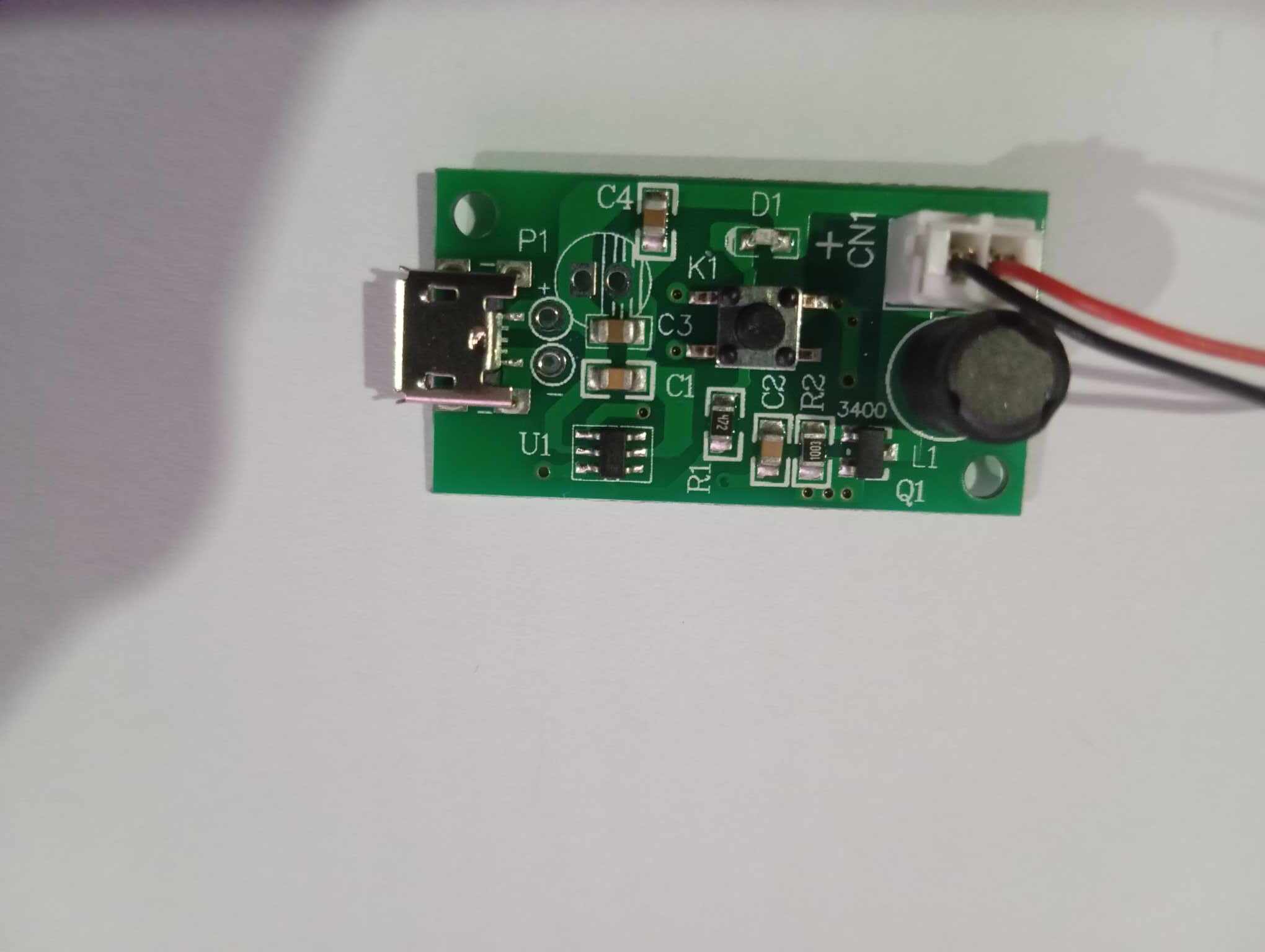

Got it. I think this is what you mean.
Yes exactly. The transducer and driver board are usually sold together. I looked for the driver board by itself but could not find one.
I actually have one of that board. However, it is for a smaller 5V transducer. I tried connecting the 25mm/12V transducer but to no avail.
Thank you so much for your help. May I ask some more please?
Please refer to the photos. The board is powered using micro-USB which is 5V. However, it has two 'power supply' pins that I can solder to. Can I solder my 12V power supply into it so that it can provide adequate power to the bigger mist maker?
Here is a closer look at the board
It may not just be a mater of voltage but also frequency. The transducer you have is designed for 1.65MHz, the board you have may be for something different.
I would not connect 12V unless you have instructions for that board that tell you you can.
Actually, the correct driver board will probably generate a voltage much higher than 12V, maybe even as high 40V in order to drive that transducer.
Thank you so much. I've learned a lot. The first being I f-ed up by buying a transducer without a driver board. Now I'm stuck with this and have to figure it out how to make it work.
