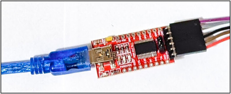

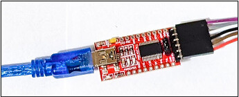

If the microcontroller has a bootloader (which the microcontrollers on the Arduino boards do, but a chip fresh from the factory does not), then you can upload to it using a USB to serial bridge cable or module, as you can see being done at this stage in the tutorial:
At the time that tutorial was written, USB to serial bridges usually were found in the form of a cable, so that is what you see in the tutorial. However, these days the modules are more common, like this one:

It is interesting and educational to learn how to use a bare ATmega328P microcontroller. If this is something you are truly interested in doing for its own sake, then go for it! However, you should be aware that it is a complex endeavor that is fraught with challenges. This could end up sidetracking you from progress on your original project. If your primary goal is to progress on your original project, then just get a replacement Arduino board and move forward..
