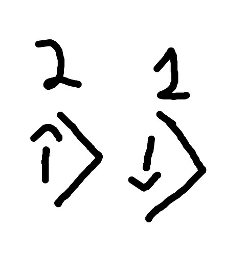

Thank you for the quick response. I would like to automate a manual task because it has caused a problem in my hand. I am a fishing net manufacturer. I want to create a mechanism, if possible using Arduino, to control a small motor, like a servo motor controller, and pass the thread through the meshes of the fishing nets. In other words, to automatically guide the needle between the meshes and control the degrees of movement of the needle up and down, so it goes straight without tangling the side meshes, all without needing to do it manually. I can send you a video of how I currently do it by hand. For now, I will send you 3 images to help you understand the materials I am using. I might have written in the wrong topic, so I apologize if I am mistaken. Could you please guide me to the right direction? Thank you

How many axes of motion does the needle need to move in? Is it only up and down or will it traverse the area of the net?

Thank you for your response. Only up and down.

That's exactly what I want but I want the movement to go up and down, what you showed me goes back and forth. Do you have something similar in mind to make it move up and down? Also to be able to adjust it's speed so it goes one with the motors that will pull the side threads to go straight, thanks a lot for the info. Appreciate.
The needle to make this movement
See reply #15
? So mount it vertically.
