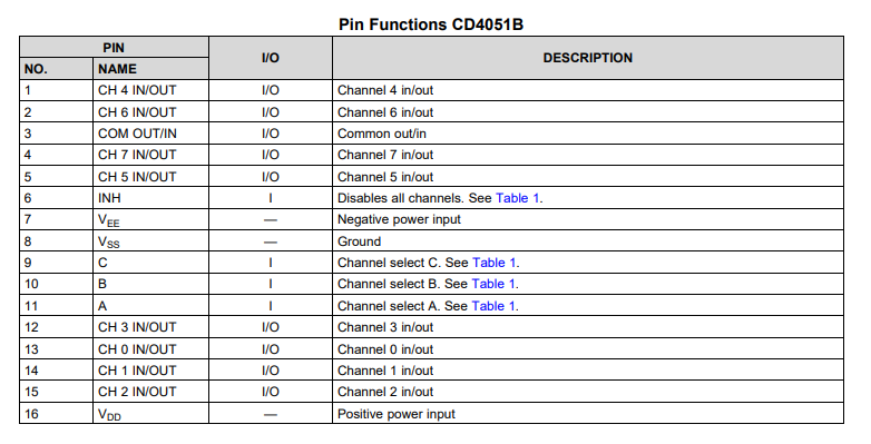

The thing is, I'm trying to select every channel from an 8-channel multiplexer (74HC4051), and show the values of the potentiometers connected in the serial monitor. I have 8 pots connected in every channel. I'm using the library Mux.h
Everything is fine until channel 3... from channel 4 to 7 the serial monitor repeats the same values than channels 0 to 3, and if a move, for example the pot connected in channel 6, nothing happens.
In other case, if I move the pot connected in channel 0 the monitor shows the same value in channel 0 and 4.
I'm doing this just to understand how I can select the channels of a multiplexer
Any, idea about what is happening? I think is the code, because when I use another code all the pots works fine
