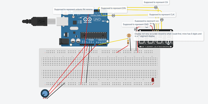

I need help proraming a Ardunio for a project. What I need programed is a little program that will control a 8 digit 7 segment display (MAX7219 ) and it will display the current time in 12 hour and it indicate PM with a little led on the first digit lighting up. The time for the clock will be set in code and preferably, easy to change. There is also an LED that needs to turn on when it gets dark, i would like it to be triggered by a LDR, and as well as that when the leds are on i have a litlle potentiometer that needs to conrol the brightness of the LED (When they are on). I have already wired it up to the following pins for the MAX7219 (7 segment 8 digit display) VCC -> 5V, GND -> GND, DIN -> 2(DIGITAL) CS -> 4(ALSO DIGITAL) CLK -> 3(DIGITAL as well). The LED is wired up to the following pins LED positive -> pin 9 (DIGITAL), LED negitive -> GND. The potentiometer is wired up to the following (could not see anymarking but could see a slight A so i will assume thats the input so its wired to A0, the other 2 pins are connected to 3.3V positive. Finally there is the LDR one end is connected to a 10k Ohm resistor that resistor is connected to the 5v positive on the end, and the otherside, that connects to the LDR is also connect to the pin A1, the otherside of the LDR is connected to GND. Thanks for any help, I bought an Ardunio uno R4 minima the other day, so I could do some projects and learn the coding langauge for the Ardunio. Also please ignore any spelling errors, sorry about them, and thank you for any help. Thanks so much, I am very new to Ardunio, and would really like some help. I have also tried to get help from chatgpt but unfortunately the code would not work as planned, no matter how much troubleshooting. I also dont know what catagory to put this so i am putting it in project guide. also just realised that the (Digital) think was not necessary.Thanks again for any help.

So this is a circuit you did not build yourself? Where does it come from? Do you have a schematic? If not, draw one. Start by posting some clear photos of the setup so people here may be able to help/comment/guide.
No worries, but consider paragraphs instead of a Wall-of-Text (TM) approach. And use a schematic or wiring diagram to illustrate the circuit, not words. Wordy descriptions are time-consuming to read and virtually always turn out to be incomplete, false or at least ambiguous.

I did wire it up, and i will try make a schematic, but my terrible soldering resulted in melted plastic around about where potenimoter had it's wiring, and it does still does work fine. (Sill learning how to use forum).

Sorry, the 'image' you posted is not good, just draw the connection you made,
A rectagle that represent R4 a rectangle that represent the display and the lines that join them 2 -> DI; 4 -> CS ... and so on for pot and ldr

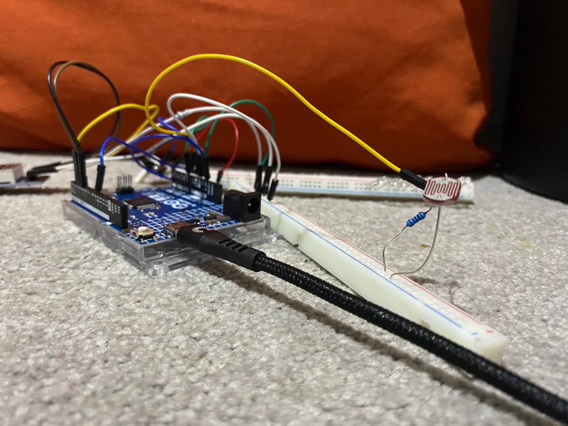

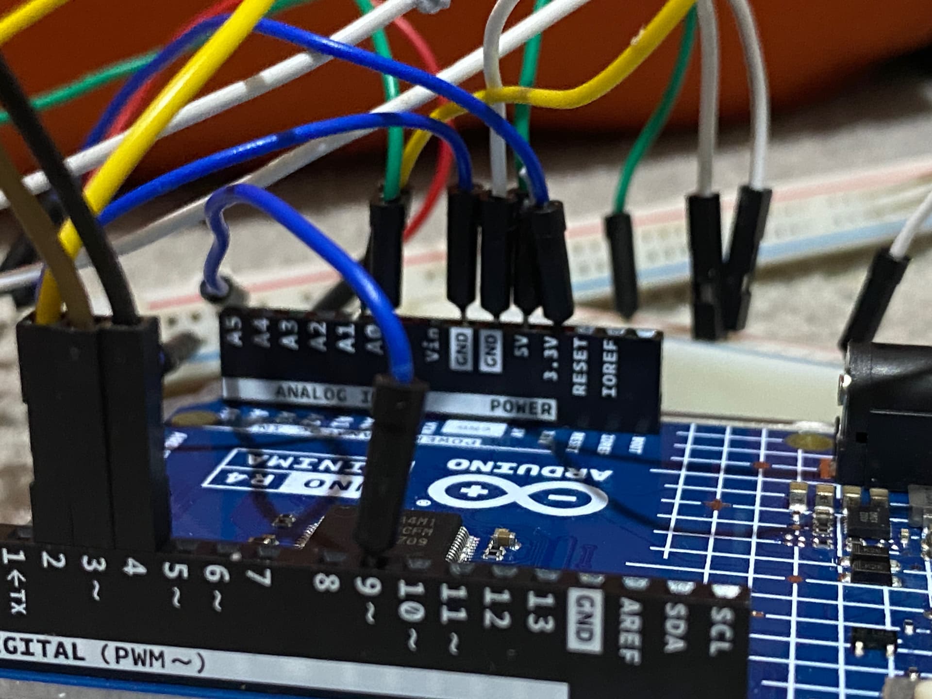

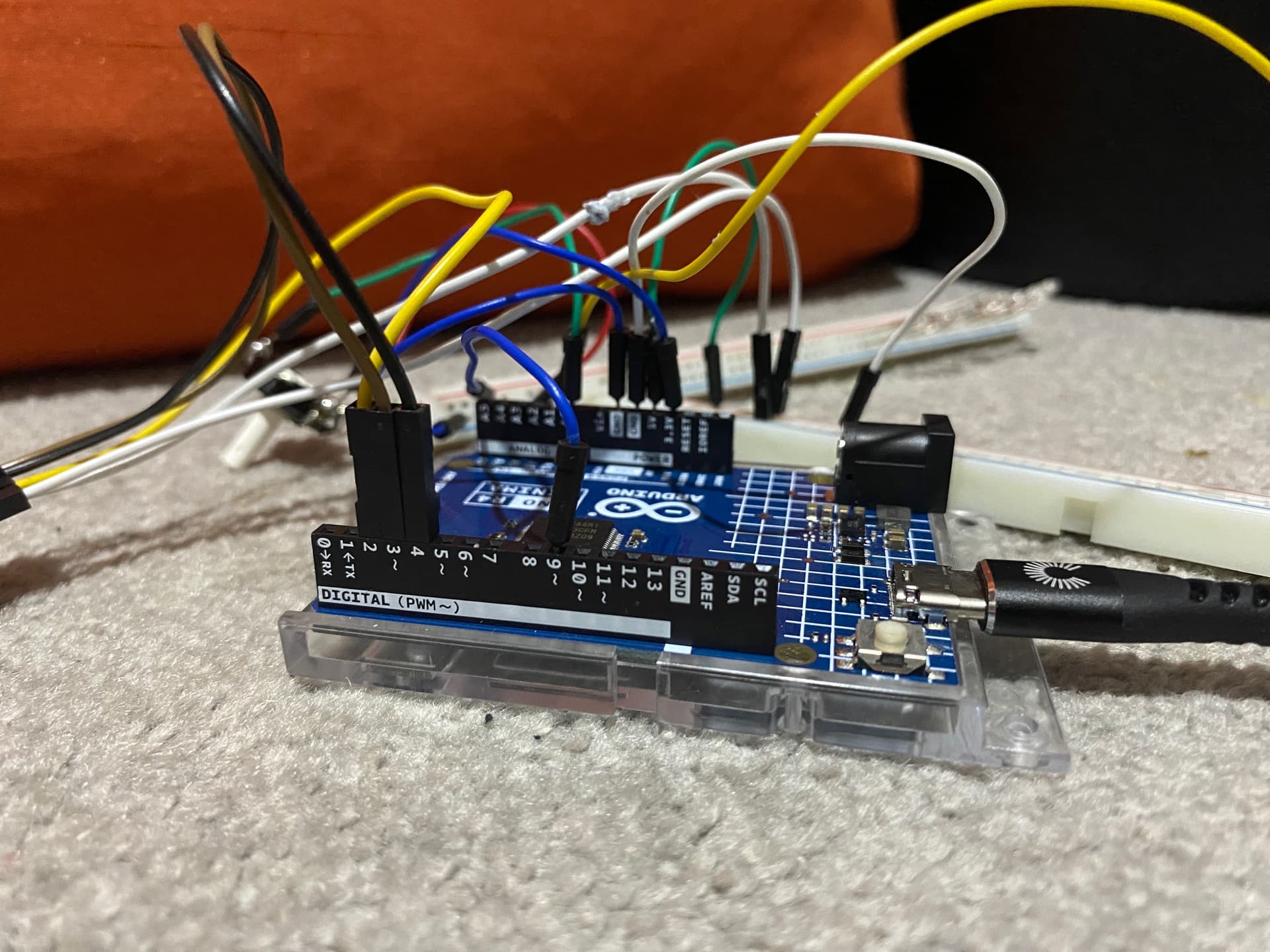

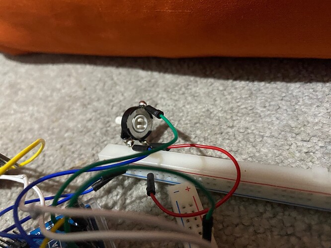

Unreadable, take photos, you look at them before posting to make sure we can see the end of every wire. It may take 4 to 6 pictures.
Throw that pot away. You don't need to solder them, they are designed to fit into the breadboard.
Sort of. If you remove the text boxes on top of the connections, it'll be easier to read.
The LED requires a series resistor to limit current draw.
You're shorting out 5V and GND on the top power bar on the solderless breadboard. I assume you didn't actually connect it this way.
Otherwise it looks like a good start. Can't judge the connections of the display; it depends on the actual display module you've got.

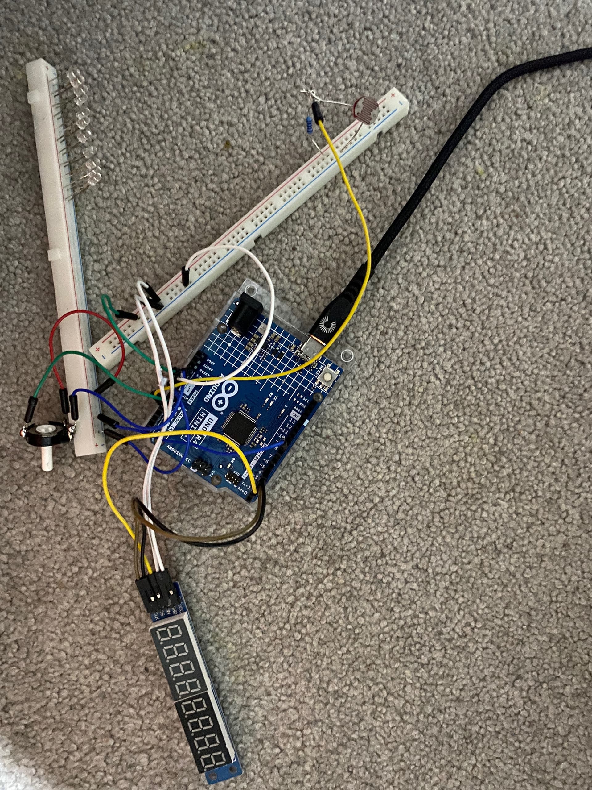

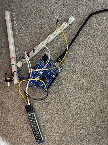

You have said that you have purchased a UNOR4, but you are showing connection using a UNOR3 -- why?
You have said that you have 8-digit MAX7219 driven display unit, but the display unit so shown does not look like that -- why?
Please, show the pictures of your Arduino UNO R4 and the display unit to get help.
Sorry but forget about Fritzy, and use proper acceptable symbols.

Yes, that is the display I am using.
I could not find an ardunio R4 in tinkercad libary, I will send pictures of ardunio when I am able to.
I did in this case because this part was salvaged, I watched a tutorial on led diming and it worked! But i could not put the complete code together and still make it work.
Take a picture of your UNOR4 and post it here.
As I said to about 3 people before I will send a picture of my setup and upload to forum, Sorry for any blurryness. I admit the wiring is very messy, but as sugested i took photo's.
(I have 5 pictues but i can only send 3 at a time).
