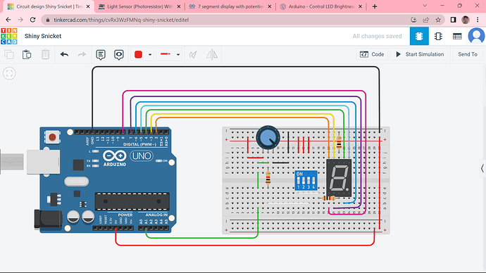

Hi first time here and barely have basic knowledge on using arduino.
I have this Sequence If i turn on the Switch (1A) the 7 segment will project the number "0". Then if i turn on the Switch (3A) which is the Potentiometer connected to the Analog pin (A1). The potentiometer then will function and will control the brightness of the 7 segment. The first sequence is done.
I've been researching in the net on how to control it but did not accomplish anything. It Will be really helpful if anyone of you will give me tips and insight on figuring this out.
You will want to use one of your digital pins as a ground pin by making it an output and setting it low. Preferably one that can be controlled by PWM (Pulse Width Modulation). You will then use the pot to change the duty cycle of that pin thus changing the brightness of your 7 segment display.

Can you draw a schematic showing how the various parts are connected? And provide more information about your 7-segment display? How much current does each segment draw? Is it Common Anode or Common Cathode?
Im using a software tinkercad for this, as i dont have any arduino at the moment. I dont know how much current it draw, and it is Common Anode

I've done what you told me to do i use the PWM. It only works on 1 specific segment of the 7 segment display which is the G segment. What do you think should i add on my code? I think its because of the Switch 1 Value "0".

Check what pins you can use as PWM. Not all are PWM.
Your pinMode needs to be in a for loop like your brightness for loop to assign OUTPUT status to those pins.
Which pin on the display is going to ground? You need to change the wiring and move the displays ground to one of the Arduino’s other pins.
Use pin 10 on the Arduino to be the displays new ground pin. Set it as an output and Low by default.
Then you can control it using the analogWrite function on that pin alone and the brightness value.
Not all the segment pins, just pin 10.
Your "circuit" in post #4 assumes we know the pinout of the display.
Its working now, it took me an hour to get what you are talking about.
