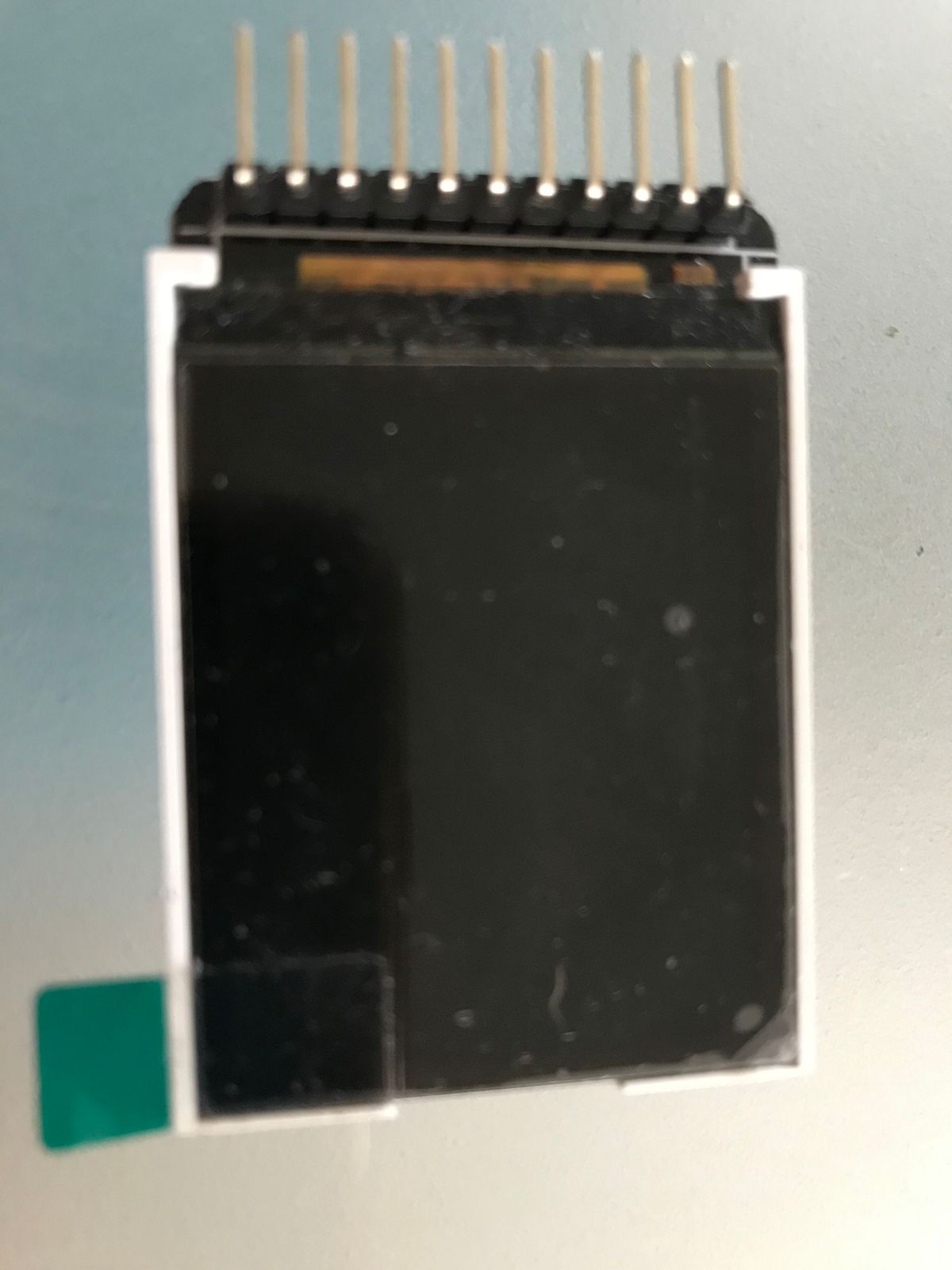

Life is much safer if you post a link to the actual screen that you have bought e.g. Ebay sale page.
Then we can identify it. And I don't have to guess.
"Joy-It" may or may not describe a screen. A sale page generally has a photo of the pcb. A photo is better than 1000 words.
You can compare your pcb with the photo. Ideally the shop has delivered the item in their advert. Describe any differences.

Seriously. It is easy to see whether a board accepts VCC=5V or whether the logic signals are 5V or 3V.
You only have to look at the pcb. What are the chip numbers ? Or post a clear photo of the pcb so that we can read the chip numbers.

To view the pcb and chips I’d need to prise up the screen and I don’t wish to do that.
I don’t have any other SPI devices but a loopback test indicated that the MKRZero SPI on pins D8, D9, D10 works, and I know that the inbuilt SD card reader on SPI pins PA12, PA13, PA15 works.
I’ve given up on the default hardware SPI constructor and have finished my project using the software SPI constructor.
You don't prise up the screen at all.
You simply view the front of the screen. i.e. where the pixels are.
Or you view the back. i.e. the pcb with the header pins.
Look at it as a sandwich. Top slice of bread is the screen. Bottom slice of bread is the pcb. You never disturb the jam in the middle. It is too sticky.

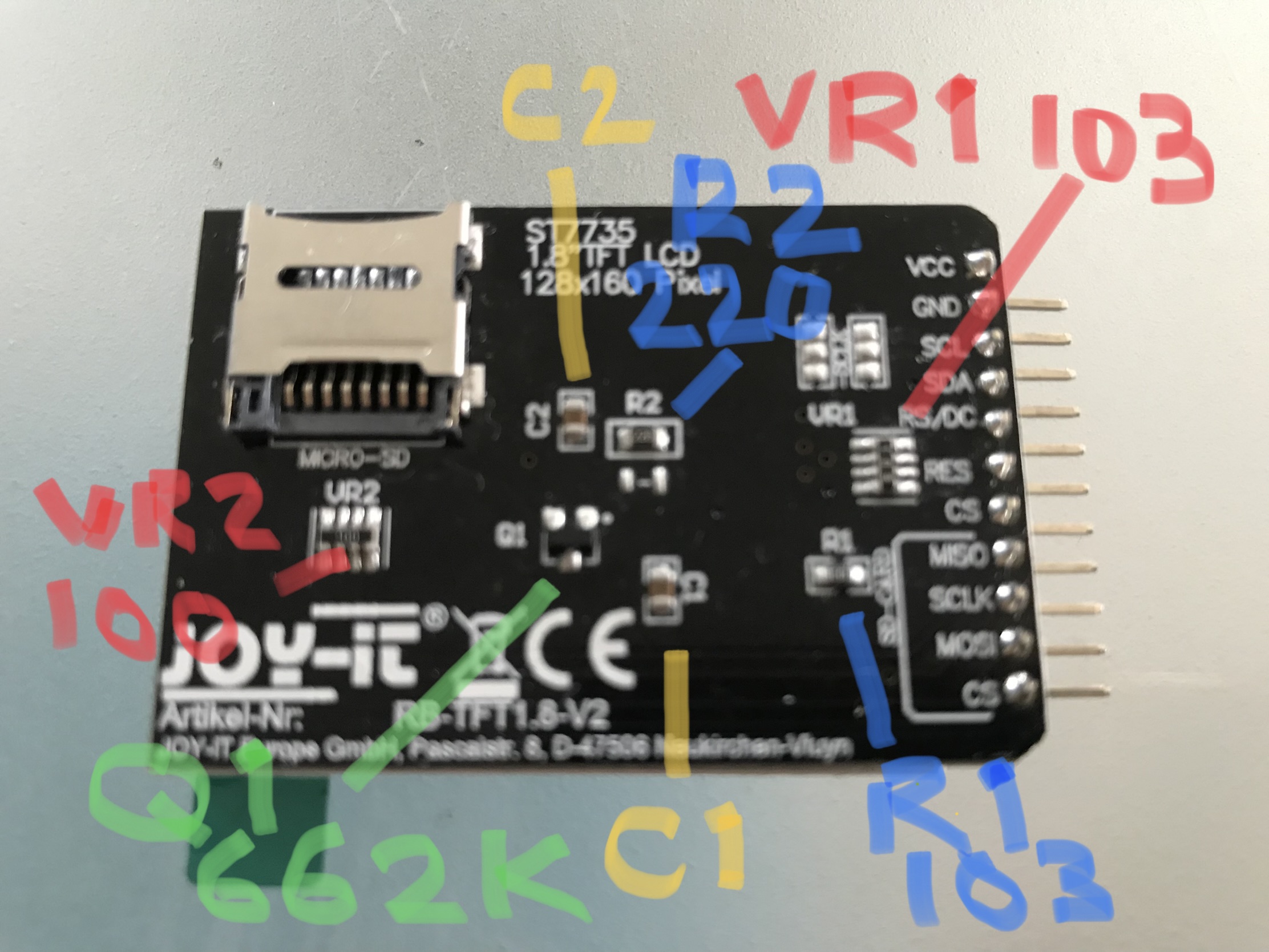

However I would be interested in the chip numbers that are visible on the Joy-It pcb.
Q1 may be a voltage regulator or perhaps a transistor.
R1, R2 are resistors
UR1, UR2 are resistor packs.
Please can you read the part number on Q1.
Please can you read the value number on UR1, UR2 e.g. 472
The convention is U1 for integrated circuit e.g. regulator
And Q1 normally means transistor.
But the Chinese do not always follow convention. Which is why a part number helps e.g. 662K
Q1 is a 3.3V voltage regulator. You can connect VCC = 3.3V - 5V
VR1 is a 10k resistor pack. You can safely connect the TFT logic signals to a 3V MCU or a 5V Uno.
VR2 is a 10R resistor pack. You can connect the microSD signals to a 3V MCU or a 5V Uno.
Since they have used series resistors (VR1) you can read the bidirectional SDA pin.
