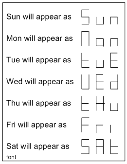

The code is ok. Its running as expected. But i need one more thing. I want to show days like sat, sun, mon etc. But I don't understand where & how to start.

What type of display do you want to use to display your time of the day and the day of the week? Is it 7-segment or Dot-matrix?

7 segment

Well, for starters, you will need some way of knowing the day of the week.
Here is a whole thread about that:
https://forum.arduino.cc/index.php?topic=198103.0
How do you want to drive your multiplexed 9-digit (6-digit for time and 3-digit for day) CC7SD Unit? Is it a direct port driven or through MAX7219 chip? Please, show/post your diagram. You need to do some works so that we can add with that or you can enlarge/modify them based on the feedback of the forum members.

From a quick look at the code, it seems that the display only has 4 digits, and it is multiplexed directly by means of the Arduino pins. Also, the code itself seems to imply that a common cathode display is being used, though a comment within that code suggests that it is common anode.
