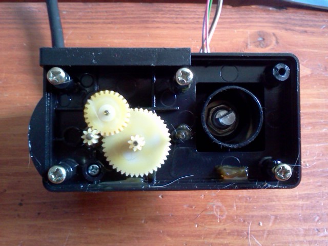

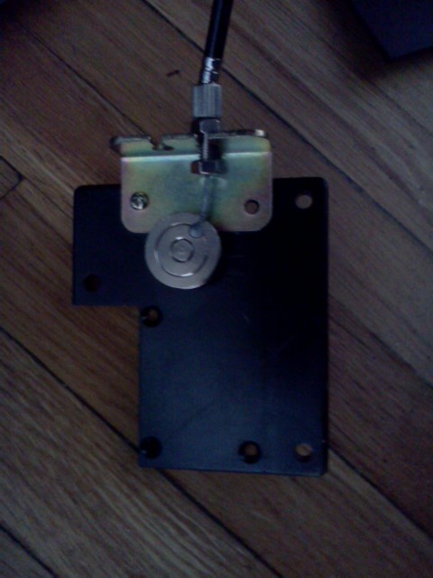

I have a Universal Fitness 795 recumbent exercise bike that got for free, the only issue is that the resistance doesn't change.. My better half was ok with that .. but i started looking online and saw that it seems to be a simple electrical issue most of the time... So i tore into the bike... and saw that it has a motor that is supposed to turn and adjust the tension on bicycle wire/cable which in turn pulls the resistance...
After opening it up further i find that there is a motor that turns the tension knob which is attached to a potentiometer i think which is supposed to control or signal when the spindle is turned to a certain level...
When i removed the gears the motor and put the batteries in the motor turns on and just spins non stop.. so am thinking it's either not getting the single to stop.. or there is a trip somewhere that keeps it running?? i tested the pot i think with a multimeter following youtube and using ohm setting i get an increasing reading at different turns on the pot.. and when the motor is going it will reverse direction depending on where i turn the pot..

I hope this pics help what I've been describing.. Thanks for your time!!
Looks like a standard servo, easy / cheap to replace. It will be for moving a magnet used
for electromagnetic braking on the flywheel I think.
More google/amazon searching and found out the little blue dial is a variable resister trimmer so some more youtubing and saw how to test one out.. opened it up to allow no resistance and everything is working!!! for now :stuck_out_tongue:
