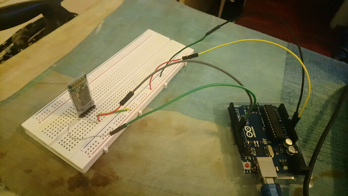

Good evening forum, I'm starting to make some projects on my arduino uno, here's the sketch I have to control the arduino internal led with my android bluetooth
#include <SoftwareSerial.h>
SoftwareSerial Bluetooth(10, 11); // RX, TX
const int led = 13;
char BluetoothData; // char of bluetooth data
Bluetooth.begin(9600); // begin bluetooth
Serial.begin(9600); // begin serial com
pinMode(led,OUTPUT);
if (Bluetooth.available()) // if there's a bluetooth data, read it
BluetoothData=Bluetooth.read();
Serial.print("El dato bluetooth es ");
Serial.println(BluetoothData);
if(BluetoothData=='1') // if data=1 ==> led on
Serial.println("bluetooth data is '1'");
digitalWrite(led,HIGH);
Bluetooth.println("ON");
if(BluetoothData=='0') // if data=0 ==> led off
Serial.println("bluetooth data is '0'");
digitalWrite(led,LOW);
Bluetooth.println("OFF");
In my android phone I use bluetooth serial controller with two buttons and I receive a bad data, so the led is still off, what I'm doing wrong

What does bad data mean? What are the hex values you are sending and what hex values are you receiving?
Your problem could be procedural rather than programming, perhaps as simple as wiring, or even power.
You might find the following background notes useful.
Your code works properly for me with my android bluetooth serial terminal app.
The software serial constructor is written from the point of view of the Arduino.
You should connect the TX of the Bluetooth module to the RX pin 10 and the RX of the Bluetooth module to TX pin 11. You may want to consider using a voltage divider on the Bluetooth RX line to reduce the 5V output from the Arduino to 3.3V for input to the module,

Thanks for the answer, I don't know if you can show me? Maybe, it's similar as the example for the AT control?, I'll attach the example sheet (I've tried the method 1)

Based on modules I have seen, I believe that the photo shows incorrect connections. However, you don't show the pin label side of the HC05 module. Try reversing the connections. Green Wire to 11, and Gray wire to 10.

First of all, Tx and Rx of the HC-05 were put on the right position, trying to reverse that, gave me no data in the Serial Monitor and the led status when I send the correct values.
I'll try the suggestions
A voltaje divider at Rx side of the HC-05, like the one showed on Method 1 for the AT commands
