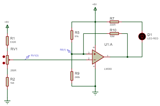

@jim-p On my schematic I have put in Lm393. Still not working correctly so am looking at what I'm doing wrong
Post your last version and we take a look.

I have got this circuit to turn the LED on and off as I want it to.
How would I get it to work with 2 comparators for 2 inputs

Replicate the same circuit with appropriately chosen resistors.
I'm surprised that you end up needing 10Meg for R10. Sounds kind of high; I'd scale down everything by an order of magnitude or so (except R7).
That was the only value that would work. Anything lower and it didn't work
The circuit in #9 (and #10) makes an adjustable deadband gap by essentially connecting one end of a pot to your R5(1) node, the other end to ground (or a node partially towards ground), and the wiper of the new pot to the second comparator reference. This makes a reference voltage lower than the one created by R5&R9.

Does this look correct. It is working as I want on the simulator
You are very close to the absolute maximum sinking current rating. I would reduce it to 10mA or less. So change R7 and R8 to 680 ohms
Oherwise, if it does what you want, it must be correct.
