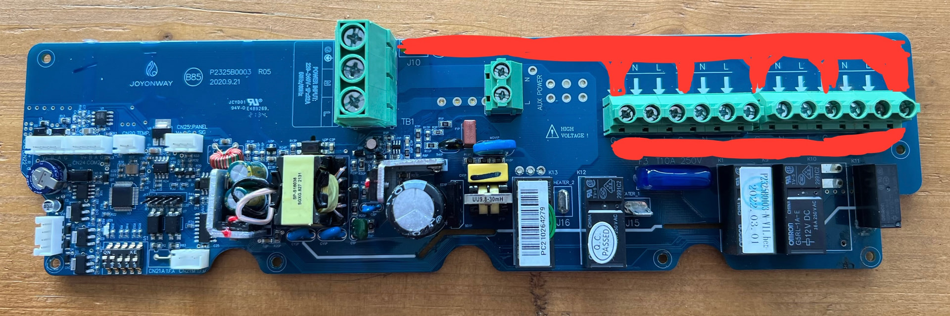

On the board, find the coil connections for the relay and trace them back..
One will go to ground, the other maybe a transistor driving it..
but does sound like it’s what ever circuit is driving the relay is what is shorted..
I would also contact the eom and see how much a replacement board is..

Ok so damn. Just got in and measured across the MOV and it’s OL so it looks like it’s not that. Was hoping that would be an easy fix.
  • is there any way of testing the relays for shorts to earth if they’re not energised? (Bare in mind it only trips when they’re energised and turn the pump on)
  • Can anyone see any other potential culprit that might trigger this trip ONLY when the pump circuit goes active?

I have just checked the MOV again with the following results all on 2Megohm setting
MOV1P - 1-1→OL
Thermistor 10.5 ohms
The two lower Y capacitors are straight to OL which my material says is an open circuit and not good. :face_with_spiral_eyes:
The ceramic capacitor shows 0.5→OL

The process on the board is the same as finding the damp kettle, but more difficult.
You could start at the mains section of the board and isolate that, maybe snip the transformer LV side leads. Check the earth/live/neutral tracks for defects.
If it goes beyond the HV side, then that's going to be a challenge.
The RCD primarily looks for imbalances in the live and neutral paths, but can trip on overload.
If you have a bench power supply, you could try powering the board separately from the transformer.
You'll have to be careful not to zap the board.
I understand. I do actually have a fish tank with an earth rod (going to a plug) for stray voltage from the equipment in there so that might be what helps cause the main RCD to trip as you say. But to test around that I bought a plug in RCD and plugged the hot tub directly into that and that tripped also so the leak from the hot tub itself must be >30mA (rating of the plug RCD)
I’ve looked everywhere I can think of on the board and can only see earth tracks shown in red below and not to any other components so I can't see where a live/neutral to earth short could even take place.
Wondering on your thoughts if it could be a live/neutral imbalance that’s causing the trip instead of a short to earth? :thinking:
