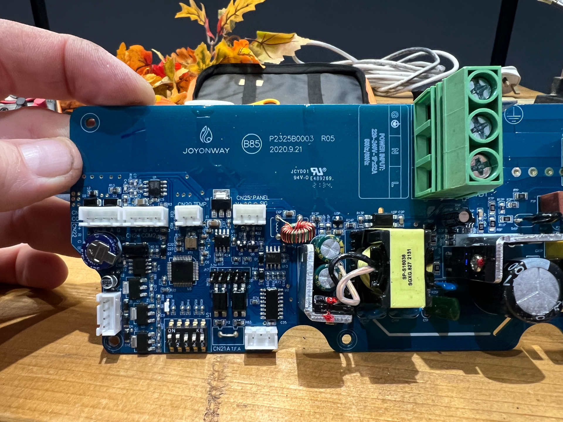

I have a hot tub which has started to trip the RCD on the main fuse board.
Cause: I was turning the pump on and off every 10 seconds or so to get rid of an airlock and then all of a sudden it tripped the RCD and hasn't been right since.
diagnostics: after a lot of playing with it I have found the following.
  • it trips even when no load is connected. ie no pump, no heater, no ozone etc so I have discounted an issue with those parts.
  • It only seems to happen when the pump turns on. (Or should turn on if connected)
  • I have removed the pump Live relay to see if that was shorting somehow to earth but it is still doing it even with the relay removed.
  • When I put my MM from Pump Live to Earth, is shows a quick spike to voltage as the pump is called to turn on (I am assuming this is causing the trip. However even with that relay removed, it's still doing it.
  • As far as I am aware, there is nothing else that should turn on other than the pump when it is called for so can't imagine it being any other relays.
Is there anything else I can do to diagnose the issue that you can think of?
Can you see anything else on the board that might be able to trip the RCD
Many many thanks guys and girls

To trip the RCD, there has to be connection to Earth contact on that circuit board.
Control all components connected to earth. Like MOV (blue disc).
I’m pretty certain it’s not a bad RCD as I put a second inline plug in one and that trips also.
It's a 240v 350w and 1500w dual speed pump. But it’s the 350w that trips it.
However, it is even tripping with the pump wires disconnected so it must be on the board somewhere.

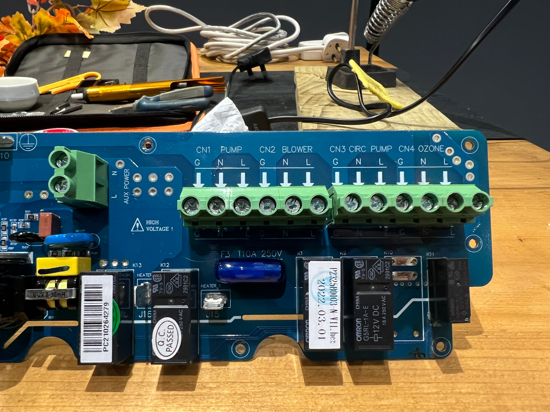

I thought it might have been the pump relay but not quite having much knowledge to test it properly I tested all 6 legs and none went to earth. But wasn’t sure if it might when it is energised. Which I can't do with the board out of the unit and unpowered, but if it was powered it would instantly trip and wouldn’t be able to test it. :man_facepalming:t2:
I removed the relay completely from the board (the one missing in the image) but it still trips the RCD so can’t have been that.
Play with your multimeter, all circuit disconnected, and measure resistances between earth(G) and the rest. If there is Line-to-Ground MOV (the blue guy), that would be first candidate.
Line or neutral.

I'll check the MOV when I get home. Haven’t checked that one yet. Wish I had before spending ours trying to get that relay off. Took me forever as didn’t gave a decent soldering iron.
I've only ever used continuity to check it, what kind of resistance values should I get if it is shorting to the earth?
Also (not knowing exactly what the MOV is or does) is it possible that it would only ‘go wrong’ upon activation of the pump?

Look for resistance below 100k ohm to earth ground.
