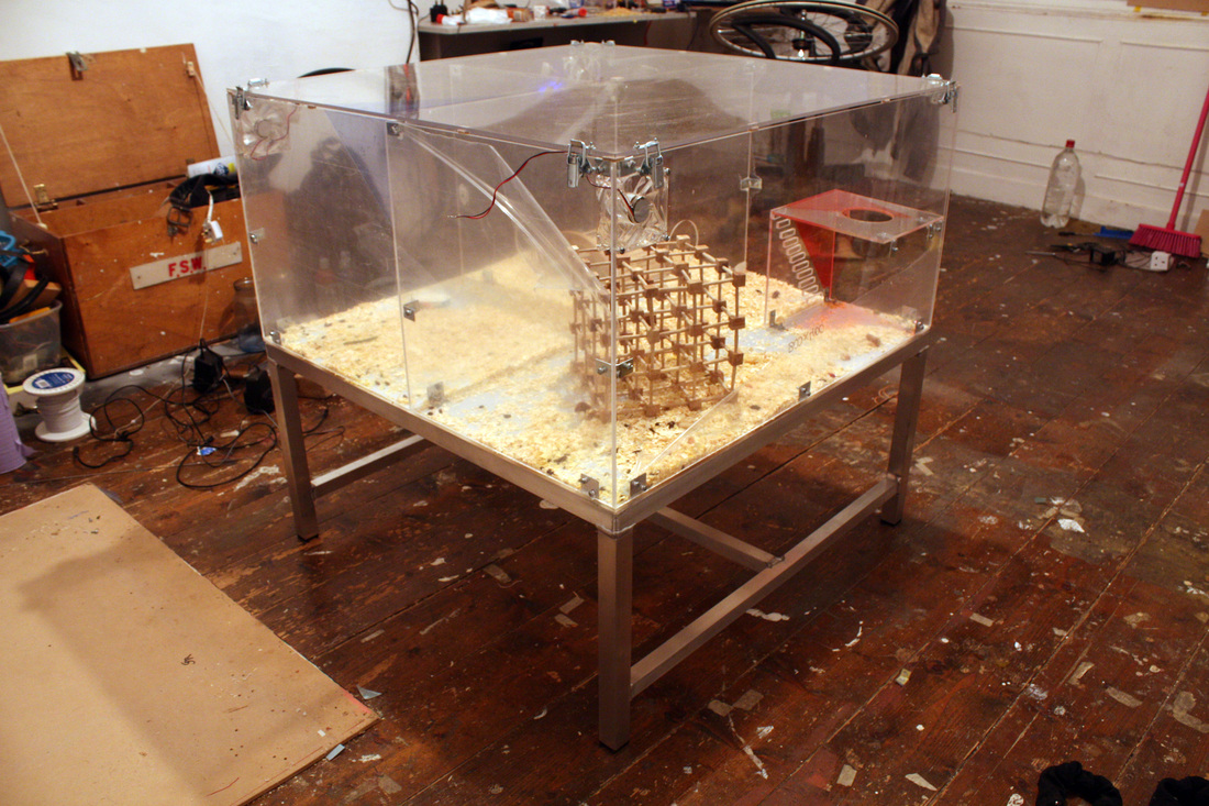

Im using stepper motors in a rat sculpture. Im trining the rats to use the feeding systems and activate the doors.
Only thing I need help with the code for the stepper motor as I am a newb and totally useless atm.
The 5v stepper motor is wired to a L293d and that is wired upto my D arduino
The rats will press the button activating the stepper motor which will turn xx amount of steps then it will pause for X seconds and reverse x steps to original
This is what I was doing last

Heres a photo of the Piece
ANY HELP IS SERIOUSLY APPRECIATED
