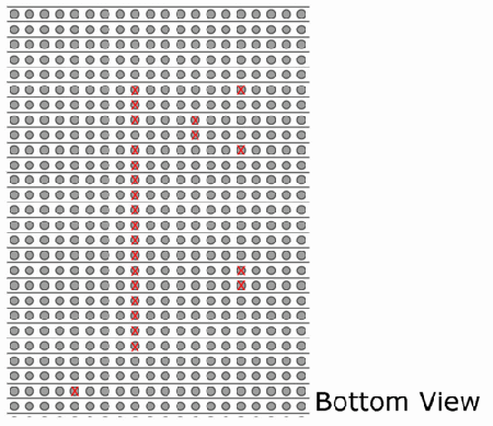

A while back I published a instructable for a Stripboard-Arduino (stripduino) Stripboard Arduino : 4 Steps - Instructables
Thought is was about time I refined the plans a little and would really like the community's input to help improve this one.
Stripboard-Arduino V1

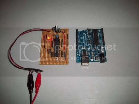

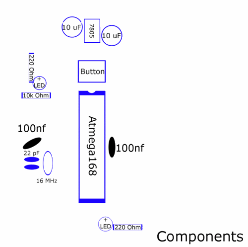

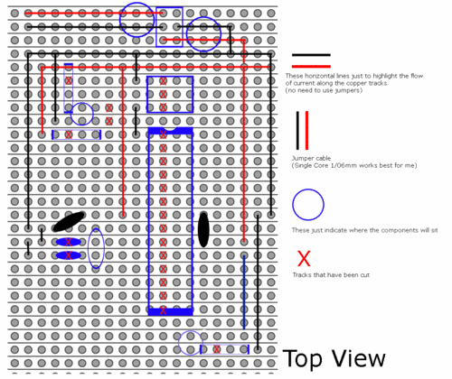

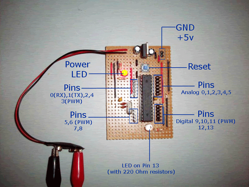

Anything you spot and think you would change, from layout to components.....just holla!
very nice. For suggestions:
  1. It's not quite arduino pin comaptible - right? Why not make it compatible to benefit from documentation and shield compatability.

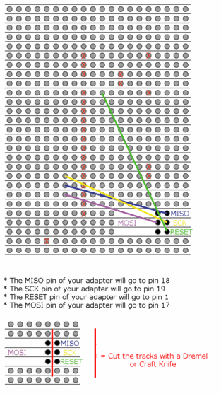

  2. I didn't see a communications port - why not put in a 6 pin header to fit a standard USB-ttl serial cable? Don't forget the power selection and auto-reset.
Maybe those would be options from your basic design.
  1. It's not quite arduino pin compatible - right? Why not make it compatible to benefit from documentation and shield compatability.
Thanks bill2009
Regards communications port, I included a small layout diagram (last picture above) that shows how to wire up a 6pin isp, but didn't actually wire it up in the photos....but will certainly included it fully in V2.
Rearguards making it Arduino shield compatible, Im really not sure if its possible to do this with stripborad, as the arduino pins don't share the standardised pin spacing......but if there is a way round it, that would be amazing!!!
Hi, n00b, these offset headers were created to align the offset Arduino pins with a standard stripboard. You could use them "in reverse" to make a standard stripboard align to the Arduino offset measurements. The 0.16" offset spacing is probably close enough to 0.15" (1-1/2 pins distance) to work Ok.
TBAr........I like the cut of your jib!
Will test it out and see if it works, my only concern is the offset starts about a mm down the leg....this may result in a wonky shied, but that what development is for!

There is also a slighty less high-tech solution to the offset header problem by another forum poster over at http://www.arduino.cc/cgi-bin/yabb2/YaBB.pl?num=1257053143
