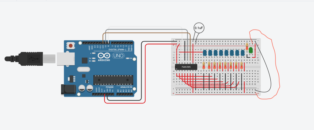

Hi, Can you help me with this?
I want to understand why this is not working

You don't seem to have the Ground rail on the bottom side of the breadboard connected up.
You're also missing a 0.1uF cap between VCC & Gnd on the shift register.
I am a beginner in arduino I didn't understand what you explained could you detail me more?

Crossroads was talking about your diagram. You don't have any connection to the blue (or red) strips of connectors at the bottom edge of the breadboard in your diagram. You also need to put a capacitor between the Vcc and GND pins of the shift register IC.
Lumos:
