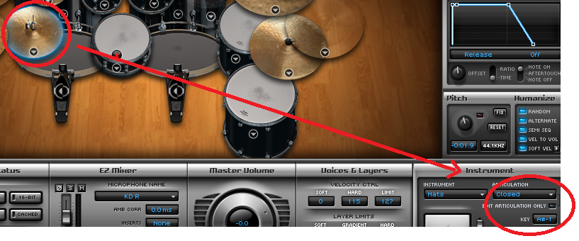

i think there might be a slight misunderstanding here... of course connection wise everything that grumpy mike suggests is right, however code wise it should not be cc 66 (as used for sustain in midi) but a midi note on command, and a note off command once the pedal is released. so the code will be slightly different. in the original post it says:
I'm planning to buy a sustain pedal momentary/on/off type https://www.amazon.com/Stage-KSP100-Universal-Sustain-Pedal/dp/B001ELP5WM to be able to control the hi hat by stepping the pedal to close the hi hat and vice versa.
that suggests he wants to control the hi hat open close drum sound via midi. but i have no idea what note number that would be...
A good point.
However if that is true then it is not the note on / note off that needs to be changed but the program number. As no program number ( voice ) is defined anywhere in the code he needs to know what two voices he wants to switch between. The solution is still the same but instead of sending two CC messages you replace these with two program change messages.
ah ok. i thought there is some kind of midi drum standard. midi note 60 (c) is a high bongo and c# is a low bongo etc. the question is if he uses something like this. here is a link: Computer Music: General MIDI Percussion Key Map
that would suggest to send two note ons (and offs) number 42 for closed hat and 46 for open hat.
There is, but that is only applicable on MIDI channel 10, the original code showed that he was using MIDI channel 2:-

so i guess the question to the op boils down to:
what kind of message does superior drummer expect to close and open the hi hat?
Thanks for all the replies. First of all, I want to say how glad I am to receive help in this community specially for a newbie like me. You guys have explained the things I need to know with my setup very well, I am now trying to study these things you guys taught me. I'll go back to the sketch and apply what you guys taught me and hopefully when I go back home from vacation I would be able to make the pedal work as a hi hat controller. I will let you guys know of the result, and about what kind of message superior drummer expects, I think I can figure that out myself, I will also let you guys know. Thank you very much.
Hi guys, I just want to let you know that I've found a better code for my setup and it is working pretty well. However I'm still having the same problem. I can't figure out how I would go about changing the code for controlling the hi hat, it seems that this code is programmed to control hi hat open/close on digitalpin # 3 using an ordinary push button. I'm almost done with my work, the only thing that I need is the code for controlling the hi hat using a momentary switch that I already have. I'm also done with soldering a 1/4 jack for connecting my pedal switch to my Arduino MEGA, I've connected it to digital pin # 2. If someone could edit this code and add the INPUT_PULLUP code for my momentary pedal switch, I can just copy and paste it to my sketch and my work will be completed and I will thank you a million times. Here's the code by the way.

Additional info: I was able to determine the type of control change I need to send Superior Drummer 2.0 by highlighting the hi hat, clicking the articulation dropdown button and selecting hi hat controller and it shows a "CC4" in the key window. Please see the attached photos. So it seems that the key for a closed hi hat sound is "A#-1", and "D0" when its fully open and a "C0" when its slightly open.
while it could be true is not consistent with:-
So I have no idea what code you need to sent. Those two quotes would suggest two different things.
Thanks everyone. I have completed my project. Cheers!
