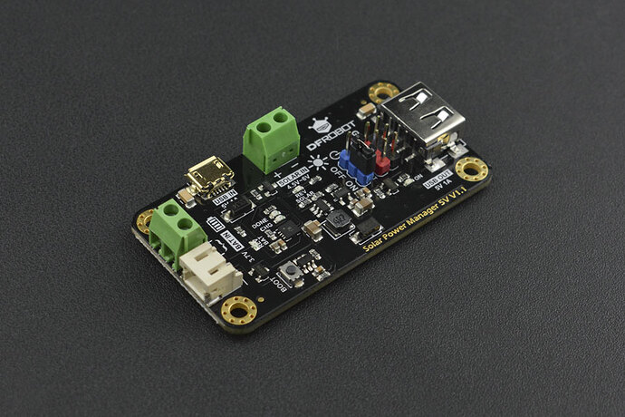

I stumbled upen this little unit: https://store.arduino.cc/products/solar-power-manager-5v?variant=39894943891607 which should be able to charge the battery. I was wondering if anyone have experience with this module? Can I somehow hook into it and see how much power it receives from the colar cell. Because if that would be possible, then I could use two of this modul, to read energy production on each of them, while charging a battery that would power everything.

What BMS?
It might be worth you reading this about the solar power manager.
Price 7.9000 USD !!
Pricey but neat.
