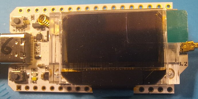

Heltec LoRa 32 v3.2: Receive a Structure Variable w/ heltec_unofficial library
I am a beginner at C++. I have looked at several examples from various forums and websites and I am caught in a vicious circle. Either I find a complete example that looks like it does do what I want, but doesn't compile, or it does compile but doesn't do what I want, and I am not knowledgeable enough to make the necessary mods, or it does but the code is incomplete and I can't seem to fill the missing part correctly.
I have come up with the sending code, which compiles and appears to work correctly, but when it comes to the receiving code, I'm hitting a brick wall and can't seem to write the correct code.
Here is the code for the sending script (based on Heltec example):

My coding is probably ugly, but it seems to work.
Could one of you help me with a code using this library which would be able to read this structure data packet?
Thanks a million!
Guy

Hi. Thanks for your quick response.
The board is a Heltec LoRa 32 v3.2. They're about identical to the v3.1, except for a couple of changes on the circuitboard which involves the power system, if I understand it right.
If you look at my code for the sending side (the weather station), it has a structure "wx_data1" which I am trying to send to the receiver unit (so point to point) at my house about 3km away (I tested the link, it works fine).
That is where I am. I can't get a receiving code to work to get that structure.
Thanks.

Avoid where possible mixing libraries, it can be very problematic.
If your using "LoRa_Structure_RX.ino" for the RX then use that libraries matching "LoRa_Structure_TX.ino" for the TX.

It's complaining about "LED1" not being defined. Do you know what is it supposed to be defined as?

Then your likely not copying the example correctly.
LED1 is defined in the 'Settings.h' file that is included with the '15_LoRa_Structure_RX.ino' file.
So if LED1 is reporting as not defined, did you edit the 15_LoRa_Structure_RX.ino to not include the 'Settings.h' file or edit 'Settings.h' to exclude the LED1 pin definition ?
