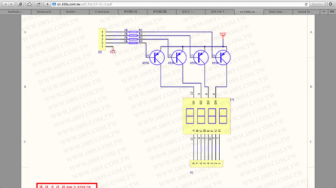

Hi there, very new here and to arduino.

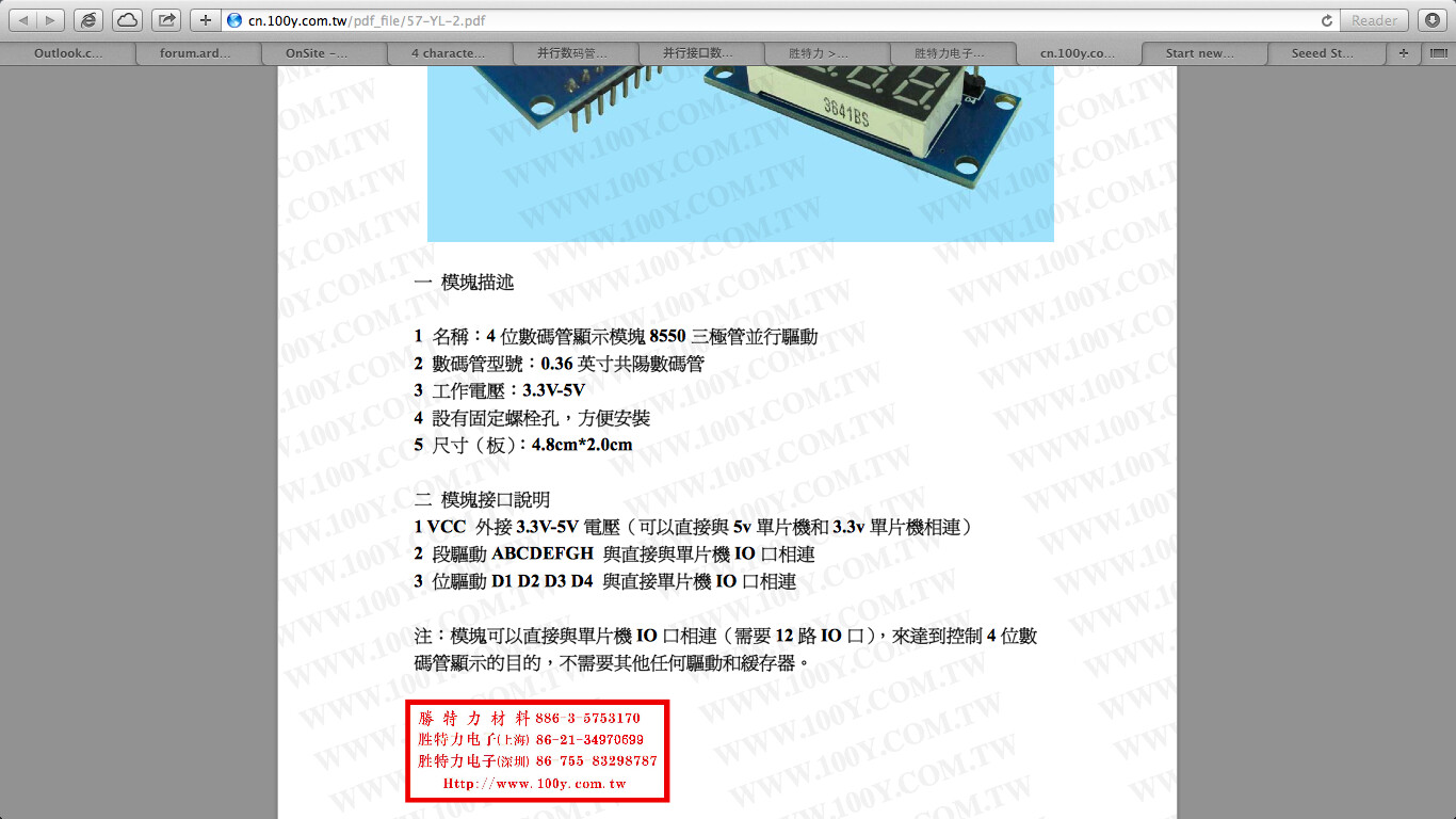

I recently bought a chinese 4 character display, and I've tried quite a few examples of how to hook one up but can't seem to get it to do anything. I managed to find the data sheet but I can't really understand it.
Ive attached the data sheet, the info is in chinese but it does have a diagram.
any pointers to get me started are appreciated.
Thanks
It's a 12pin common anode 4x7 display. You will probably be best off using it with a 74HC595 8 Bit Shift Register. There is likely to be a raft of information in the Arduino playground.
You need to give the links (URLs) to the vendor's page and the datasheet.
That's a 'multiplexed' display so you might want to look through the 'LEDs and Multiplexing' section of the forum.

Thanks for the heads up guys, I'm not sure what a multiplex is or an 8 bit shift register but I will do some research on that and post in the led/multiplex forum
I'm not sure the 74HC595 is the right device for common anode displays but, if it isn't, there will be something like it that is!
Managed to find a library on github for dealing with seven segment displays, with this I dont need the shift register. GitHub - DeanIsMe/SevSeg: Seven segment display controller library for Arduino
All sections are lighting up now, the output is just a bit garbled, i guess I have the pins in the wrong places.
Maybe... you could use the (very old) 74HCT47 IC? It gives the right seven segments output, but is BCD coded, so the input bits only go to 1001

For this common anode 7Seg display I think that the TPIC6B595 would be suitable

Yes, use common anode display with TPIC6B595, combines HC595 & ULN2803 into one chip.
Note - that library cannot negate the fact that you still need the correct driver/transistor etc for these displays IMHO
I see so the seven segment display still needs a shift register, otherwise it will only display random segments no matter how I wire it?
No. The shift register just cuts down on the number of I/O pins that are required.
