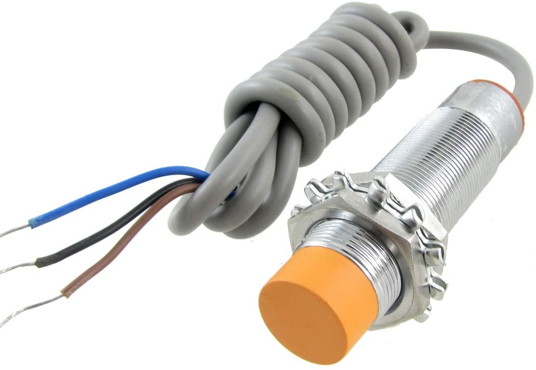

Some of those NPN inductive sensors have an internal pullup.
What's the part# or link to your sensor?
Im gonna use an uno for the project, and the npn sensor I will use is this one:
part #: LJ18A3-8-Z/BX
I am unsure whether it has an internal pullup, and I do not know whether the output voltage is dependent on input.
Also where could I find proper examples on dividing the voltage from 12v to 5v for the output?
This is my first project of the sort so I appreciate any help that could guide me to the right set-up!
I think it has a built-in 10K pullup (found this image on the web)
Are the wire colors as in the diagram? If so, with the +12V connected to Marron (or brown) and battery -ve (GND) connected to blue, measure the voltage from the black to blue wire. Should get 12V (battery voltage) when switched off and near 0V when switched on.
If the voltage switches from about 12V to about 0V, then try connecting a 6.8K resistor from the black to the blue wire. Re-test the voltages and see if you're getting from about 5V to 0V. If so, then it's ready to connect to your 5V Arduino board. Make sure the resistor is securely in place.
