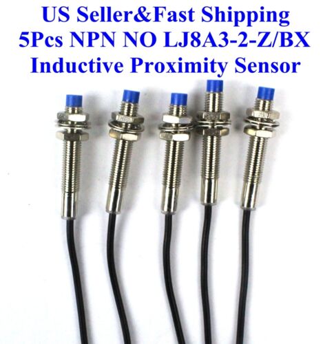

Hello .. I'm having a problem with my NPN Proximity Sensors and voltage. The sensors use 6 to 30 volts. I'm able to get them to work with using the 5v from the Arduino Uno. I'm using digital input 2 for the input signal.
But I know when I install them that due to the length of wire they are not going to work due to voltage drop. So I want to use 9 volts to power them.
Now here's the problem.. The sensors are normal open. But when I test them with my meter i'm getting 9v while open. and when I close the sensor I get ground ..
My concern is that when the sensor is open the 9v is going to fry the board..
Don't ask me why I'm getting a voltage return.. It should be open with no return at all and when its closed a ground should just return.
Can I just use the internal PULL_UP resistor to knock down the 9v to 5v or do I need to add one??
I watched a youtube video were he just used the internal.. But I don't want to fry the board just to test..
The rather unhelpful spec sheet is not clear about whether the output is open collector.
If you measure voltage at any time on the output, then it probably is not open collector, and you cannot connect it directly to an Arduino input.
Instead, use a voltage divider. Two resistors in series, say 5K Ohms, from output to ground will bring 9V down to about 4.5V at the junction, which is safe for the input to a 5V Arduino.

Hey Outsider.. What I did was I attached the +5v to Brown and the -5v to Blue. Black is the return. So with my meter attached to the +5v I attached my Negative probe to black and then activated the sensor.. The meter reads nothing deactivated and 5v activated.. Which was great..
But .. When I would attach the probe to my -5v negative Blue and probe my Black it reads +5v while deactivated and nothing when activated. So if I'm getting +5v while its supposed to be in an open state something's wrong.. It could be me.. I'm willing to admit that.. I could be doing something wrong.

Hey Rickerman.. When I tested the sensor with my meter the voltage was directly from the power supply. They were not attached to the Arduino and had no pull_up resistor. I attached the power to Brown. The ground to blue. and black is my signal.
with it not activated the black and blue says 5v..
When activated the black and blue says zero because it zeros out the meter because the black wire signal turns to ground.
When activated I switch the lead on my meter from blue to brown. Now I get a 5v reading on my meter.
Which means for some reason my black signal wire is switching from +5 un-active to ground active.
which would be fine if I could get away with 5v.. But 5v is already under powering them. and these sensors will be at the end of a 25ft wire. The voltage drop will make then not work at all with 5v.
I hope this explains it a little better.. I do appreciate all the help on this.. Thx
Sounds like there's a pull-up resistor in place on the output.
That's a pity, as it means you're getting the 9V to your pin.
When you have a sufficiently large pull-up resistor value (and I may assume you don't know the actual value!) you could rely on the clamping diodes. A 10k between the pin and the sensor output should be safe: you'd have only 0.35 mA (9V - 5.5 means 3.5V over the resistor).
Alternatively, use the diode + pull-up resistor method.
