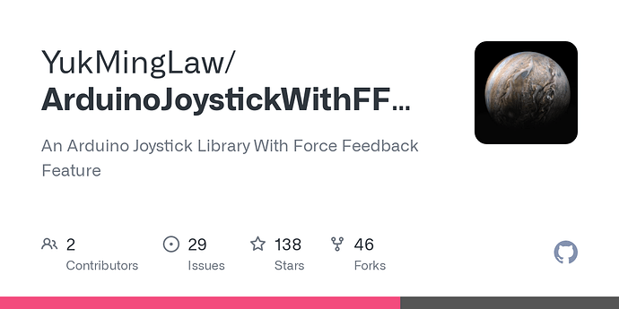

How can I make a FFB steering wheel in terms of code?
I saw this library and wanted to see if I could use it.
The hardware is already done. I have an arduino leonardo, a driver for my motor along with a motor and also a rotary encoder. I just can't figure out how to use it to actually drive the motors. I don't really get what the pins do in the example code.

What I meant was i don't know what the pins in the code are supposed to do. When I tried to test it, forces didn't ever change. Now I tried changing some things and Windows recognizes it now. Apparently it wouldn't recognize multi axes.
On GitHub it explains how to set it up internally but then fails to mention what the pins in the example code are specifically for. So I thought maybe someone here used this library themselves and knows how to set it up.
  pinMode(A2, INPUT); // potentiometer for steering wheel
  pinMode(9, OUTPUT); // PWM for intensity of feedback for driver module
  pinMode(6, OUTPUT); // next two pins are to setup direction of rotation for driver module
  pinMode(7, OUTPUT);
Oh wow, yeah that makes sense. I'm way too tired if I didn't see this myself. Changed some stuff since I'm using an encoder but now I know to put 9 on motor driver enable. Thanks a lot.
