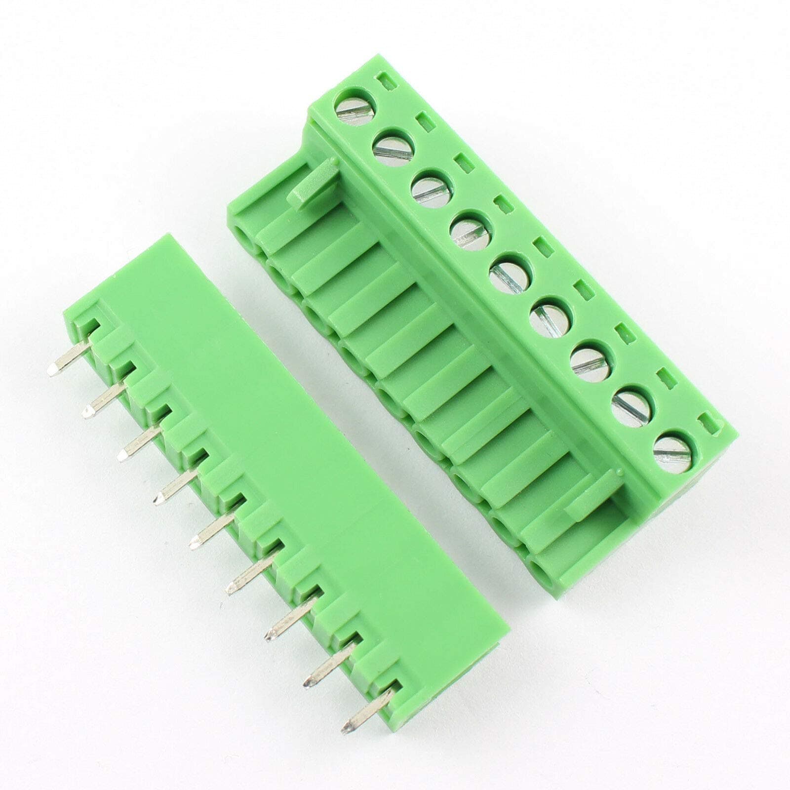

I thought screw terminals would still have the wires being connected one by one unlike sockets.
yeah, it's one by one, connecting 9 wires to each of the 9 screws, where something like sockets can just plug 9 wires at once to one connector
The image above is a socket, male/female. Somehow you need to connect the wires to ANY type of socket...
