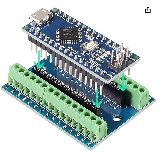

How can I turn all Arduino jumper connections into one unified plug?
I'm trying to combine all the jumper wire connections to my Arduino into a single plug/socket, so that everything can be plugged or unplugged at once — neatly and without the risk of mixing up which wire goes where.
This feels especially important because the Arduino is used for a job, and it may need maintenance when I'm no longer around.
What’s the best method to turn multiple Arduino pin connections (whether from jumper wires or other cables) into a unified connector system, like a proper plug or socket?
Would love suggestions on what parts, headers, or techniques people here use for this.
Use a shield?

What you do is solder male pins to the Arduino then solder female hdrs to a perf board. Now the Arduino can be removed without touching the wires. Sooder the wires to the bottom of the female hdrs. Or buy a screw base. Here is Amazon.CA link and a screen grab.

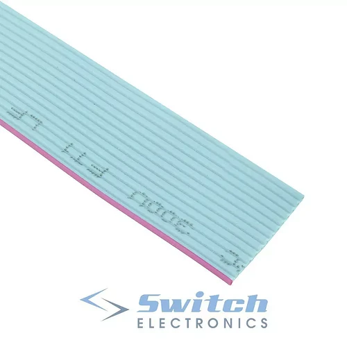

IDC sockets & plugs
Ribbon cables

The screw base would still have the individual wires used on it, albeit not directly on the Arduino, not combined.
so this'd require modifying the Arduino to replace its current I/O pin with this one?

You can get pin or socket terminals. The example I showed plugs into an UNO. The other ends have socket connectors for sensors and LEDs.
The only connector that fits the female header on the Arduino Uno is this one:
However, it needs to be soldered onto a piece of perfboard, to which the necessary wires should then be soldered. This is the recommended approach if you want a reliable and trouble-free electrical connection over the long term.
Other connectors, including jumper wires and even Dupont connectors, do not have the same cross-section and do not guarantee proper contact.
For professional use, in my opinion, there's no other choice. You can also create a perfboard or a PCB with male headers and plug the Arduino onto it upside down.

You remove the plastic housings from the current single pins that plug into the Uno. They come out very easily by lifting the small plastic tag that holds them in place. The you insert the same pins into a multi pin housing as illustrated by @oldcurmudgeon
so it means that you keep the female header inside then plug pin/socket terminals like from @oldcurmudgeon's post on it?
You make no changes to the Arduino board, if that is what you mean
For this one, I tried that and it feels that the black part melts quickly when I tried soldering wires there, and the soldering result seems to snap easily as well. Dunno if there'd be a solution for that.
