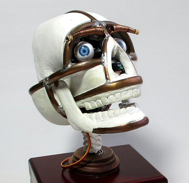

You obviously need to determine what "make a robot head" means. The instructor may want you to design and fabricate from scratch using your own design or they may be happy if you were to use an existing design.
Given the course content of the 3 year DAE Mechatronics course - (assuming it's this course) - the intention may be to design from scratch.
It may be something as simple as this one from pyroelectro:
or maybe this one:
Unless you are part of a team, then I think you are going to have to go with a simple design in order to have the project completed within 2 months.
