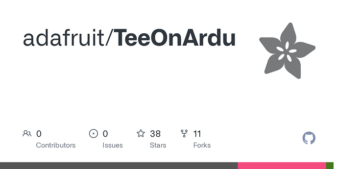

I don't know anything about this subject but are you aware of this?:
pert:
GitHub - adafruit/TeeOnArdu
A lot of thanks pert!
Unfortunately TeeOnArdu is not ready to reset with "1200bps touch":
To upload new sketches you just have to press the reset button each time you hit the upload button. Like in the old days of the first Arduino generations
