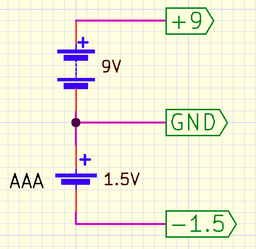

Then the simplest solution is to use two 9V batteries.
GND is common to both the op-amp circuit and the Arduino.
Connect the +9V to the Arduino Vin, no need for a 5V regulator
Many dual supply op-amps can work with unsymmetrical supplies.
If the output will never go negative then you could also use this circuit.
I think I will use separate power supplies to isolate the loads.
Sure, if you don't want to use batteries that will also work.
Just make sure the outputs are isolated, because you are connecting the positive of one to the negative of the other.
