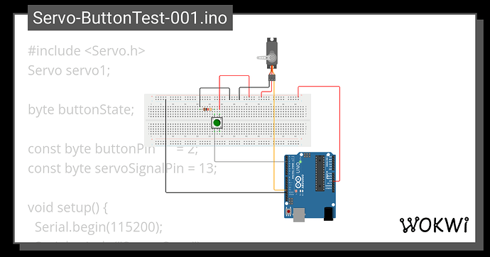

Hi @paulamotta ,

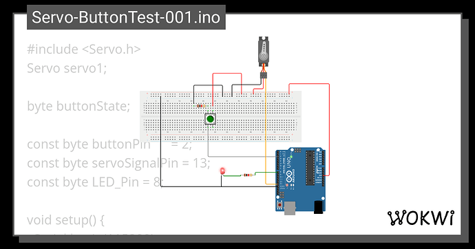

watch the simulation until
CONTINUE microcontroller goes on appears
I have build two WOKWI-simulations that rebuild your exercise
one to one like you did using the blocking command delay()
delay() means:
stop microcontroller comletely until delay-time is over.
and then a second version that uses non-blocking timing.
This second version does blink in LED all the time
Even in case the program keeps the servo in position 180 and is waiting for
turning the servo back to position 0
As soon as you want your program to be responsive to button-presses or if you want to do
a second, third, fourth action in parallel to some other action non-blocking timing is required
It will take some time to understand this second code-version but it shows a somehow advanced functionality as it blinks the LED continiously in parallel to the waiting
additionally here is a demo where the LED-blinking and the servo have timing in a blocking way
through the use of delay()
The wait-times are 2 seconds and 3 seconds long to make it easier to realise what is happening.
You have to keep the button pressed down until the LED goes of
in all other cases the program does not detect the button-press
best regards Stefan
