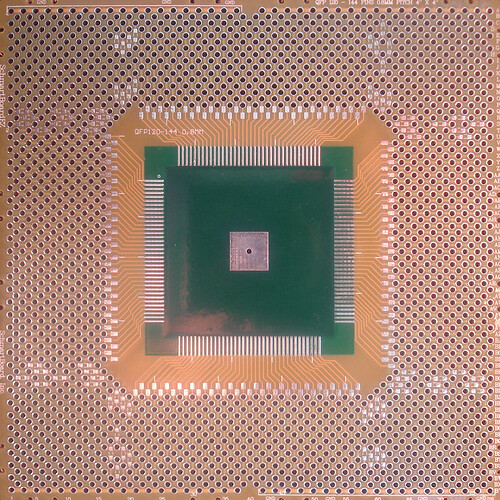

I came across these QFP > DIP adapters for breadboarding - is this how it's done with the more intricate QFP components? With the simpler ATmega chips it's not a problem because of their DIP design.

http://schmartboard.com has a 144pin adapter that looks like it would fit the SAM3?
No, what happens is that you go straight to PCB layout and then correct any errors with a scalpel and some solid core 32 gauge wire, known as mod wire.
It is assumed that if you are using such a complex chip then your design skills will be up to it.
