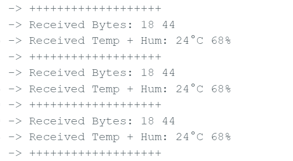

So i tried my best and reworked the code. The "transmitter" now writes the temperature and the humidity as bytes. Additionally, i added a start and an end byte. Here is my Code:

This is how the Code is received:

Am i really transmitting binary information? I'm so unsure if I'm doing it right. My serial monitor looks like this:
The Values seem to be plausible.
Is your temperature can be only positive?
Yeah, it can only be positive. Do you think i should make it "unsigned" ?
It is your decision
1. What sketch are you going to present if you are asked to send 0x23 reliably from Sender (UNO) to Receiver (NANO/UNO-2) using SUART (5, 6) Port (Software UART Port) ? The word "reliably' emphasizes that the message/data (here: 0x23) has a "Start Mark" and an "End Mark". How are you going choose the "Start Mark" byte and "End Mark" Byte?
2. Assume that the "Start Mark" byte is 0xFF, will the data byte 0xFF be received by the receiver? Data byte (in general) can be anything from 0x00 - 0xFF.
3. Assume that the "End Mark" byte is 0x00, will the data byte 0x00 be received by the receiver? Data byte (in general) can be anything from 0x00 - 0xFF.
It is important that the asynchronous Serial Protocol is understood correctly. There is something called ASCII coded transmission which makes a chaos (Step-2, 3) free transmission.
Why does it need to be SUART ?
I thought I would use the TX and RX pins to read the sensor
I chose 0xFF and 0x00 as an Example. The data sheet even specified 0xFF as the start marker. I then simply assumed that the data bits would not contain any 0xFF. The "End Mark" byte is unknown to me, as I can't find any reference to it in the datasheet. So i thougt i choose the complete "opposite" of 0xFF.
At first I thought it would work that way. But now I think it might be possible that the receiving Arduino starts reading the incoming information again when the start marker appears in the data bytes.
Same for the End Marker. I guess?
In my imagination, the stop and start markers did not appear in the data bits.
At this point, I also ask myself how I get to the stop bit. As it does not appear in the data sheet.
(Only Parity and/or checksum Bits)
How do i achieve a "logic high" for my stop bit?
Wow. It took me a while, but now I understand that the data type "byte" is already an unsigned datatype (and arduino exclusive?). So if my temperature could be negative, I had to choose another datatype.
