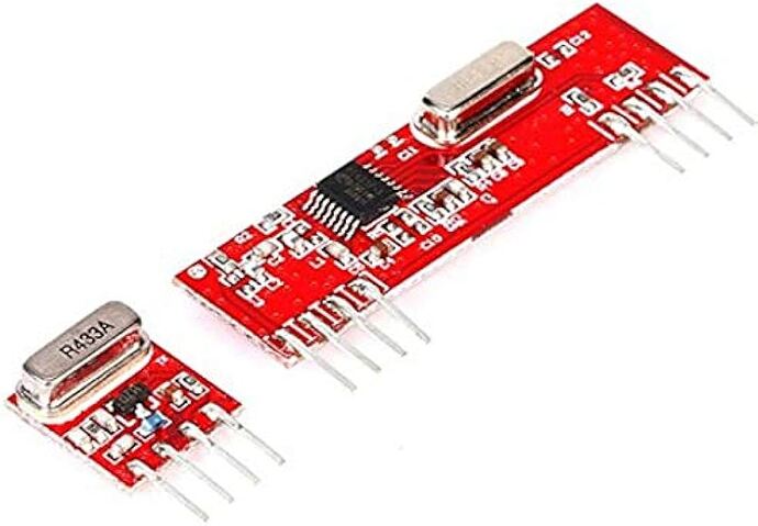

i am going to use Rf 433 mhz red pair .
i want to connect RF transmitter to Arduino pro 2560.

Radiohead handles regular ASK simple radio sets, and the OP is using a plain old 433 simple radio set.
So shouldn't that just work, and work on any i/o pins what might be left over?

The pictured radio set is probably these simple dumb ASK modules:
They are suitable for RadioHead. The charter of RadioHead is radio-agnostic high level software; RadioHead's RH_ASK class is useful here.
RH_ASK inherits from the RHGenericDriver. The constructor allows setting the pins used.
RH_ASK (uint16_t speed=2000, uint8_t rxPin=11, uint8_t txPin=12, uint8_t pttPin=10, bool pttInverted=false)

There is no need to use a serial capable pin, a UART or SoftwareSerial.
