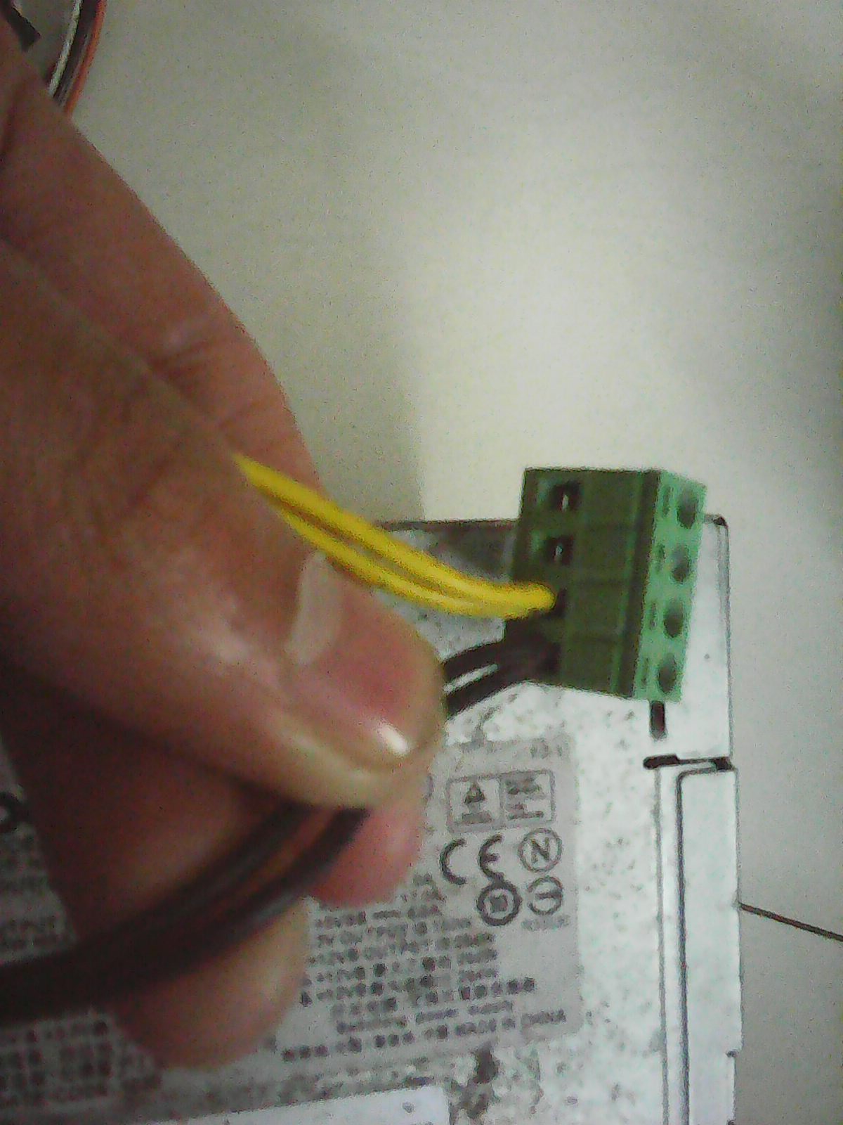

I bought the RAMPS and Arduino Mega 2560 and 5 stepper drivers for my prusa mendel. I plugged in everything to the pc and everything was working perfectly. I installed all my arduino drivers easily. I used a 350w psu, but had some problems as 2 motors didn't work together so the arduino turned off when two drivers were plugged in. but still i could use a single driver. Then at my friends place when I plugged the psu to the mains and turned everything on, 1 of the stepper drivers started smoking from the chip attached to it and got fried. I think it was due to too much voltage. After a while removing the burnt driver when I connected my Arduino to the pc,(no RAMPS attached) the pc did not find its hardware. Only this 1 light stays on and nothing happens. I don't see that there is any physical damage to the board.. but there might be .. I am not sure what to do now.. I want to know if I can check weather the board is still working and how can I connect it to the pc? please help me ![]()

I just plugged in the 5volt pins with a 305Watt psu connected to mains.The psu has
+12VA=18.0A,
+12VB=18.0A,
+5V=22.0A,
-12V=1.0A,
+3.3V=17.0A,
+5VSB=4.0A outputs. I connected the 12volt 18A output to the 5volt input in the RAMPS
