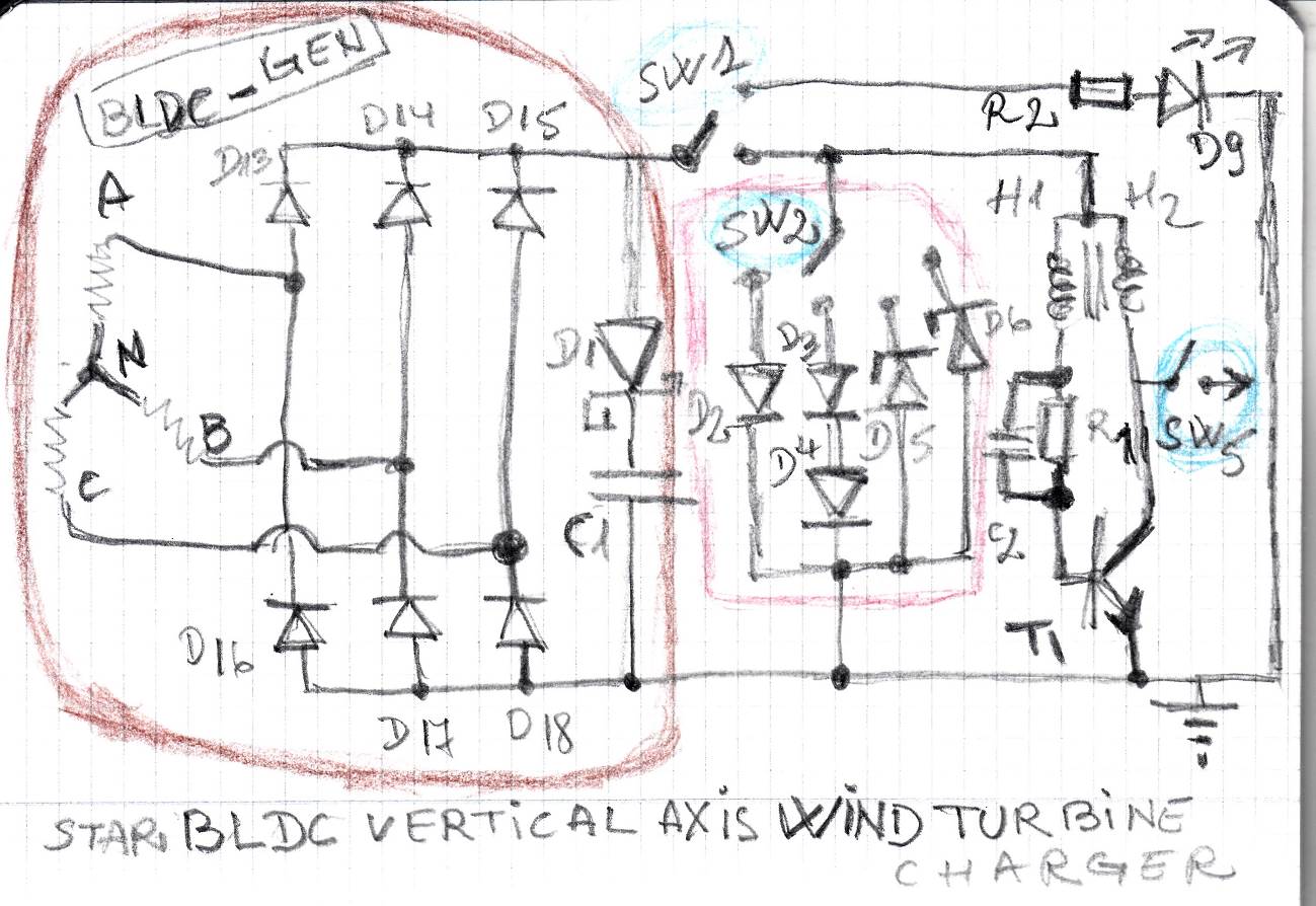

While wiring the BLDC, I re-planned the circuitry of the wind generator.
It is one step forward to integration with the PV component: the output is to be connected via SW5 to the same battery as the PV charger.
Here it is:
In brown, the BLDC and corresponding rectifier.
In red, the step by step voltage regulator for the Joule thief to function.
This is a demo project for kids, simplicity is more important than efficiency. Only passive components, diodes and transistors are allowed.

In this latest diagram, what is the purpose of D1 and C1? To me, it looks like they do nothing.
@MorganS
C1 is to smooth the output, since the H regulator made in 6 diodes are not so effective in obtaining a straight DC line. In my understanding, the D1 serves to improve the effect of the C1.

falexandru:
It completely negates the effect of C1, as the charge can't flow back out of the capacitor. Remove D1 and the capacitor can do its job.
@wvmarle
I had the same impression. But I was assuming that it has something to do with the waveform of the output. I was not able to check this assumption because of failing to operate the oscilloscope. I hope I can either find a tutorial in a langue I know or I will afford a bench oscilloscope.
Anyway, in the experiments there was no D1 but only the C1 and the JT output was enough to power my white LED. Therefore I will remove the D1.

wvmarle:
I just tried a DC motor (from an air pump, brushed type): turning one direction I easily got 3-5V out of it (I connected it to an electric drill to turn it), the other direction nothing significant. Didn't know they're directional. Of note: it was a sawtooth shaped voltage that came out of it (basically an open circuit, just scope attached).
BLDC motors indeed need six diodes for the three phases. A good cap to smooth the signal may also help the joule thief a lot.
