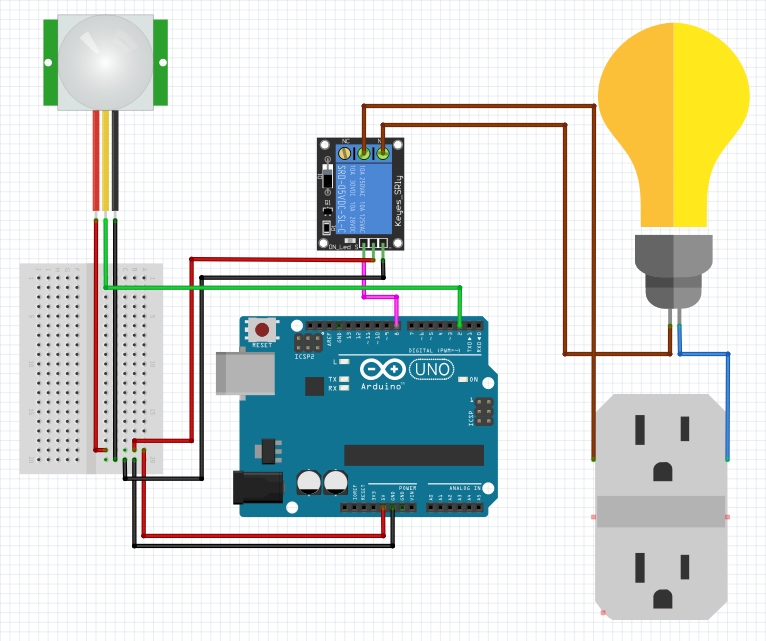

The green and yellow wire is a ground. You can ignore the ground wire and just use the blue and brown wire as you would do for the other lightbulbs or run a separate ground wire to the light.
Would the ground in the arduino board work?
The Arduino board does not have an earth ground. The Arduino has a common being used as a ground. I'd run a separate earth ground wire to the light. I'd not use the common ground of the Arduino as a earth ground.

Brown should go to your relay. A black wire should go from relay to light bulb (may also be brown). The blue lead can be connected to the other end of the bulb. The blue one is supposed to be at 0 V!
At least that is the standard in NL and I think also EU. In USA colors are different.

The lamp is either EU or Asian. Brown is live, blue is neutral and green/yellow is ground.
In the U.S., green is neutral (easy), black is live and white is neutral.
We are only dealing with "L1", "N", and "ground" or "earthing" here.
It's not a massively huge deal if you wire them opposite (because it's AC), but you shouldn't, and bad things can still happen.
So something like this?
I couldn't find a EU plug component in Fritzing so I used the american one.
Yup!
Yes. You want to switch the "hot" side.
Don't forget to ground/earth the light (it need a ground because it have a metal case). And while you are at it, you can earth/ground your arduino, too.
